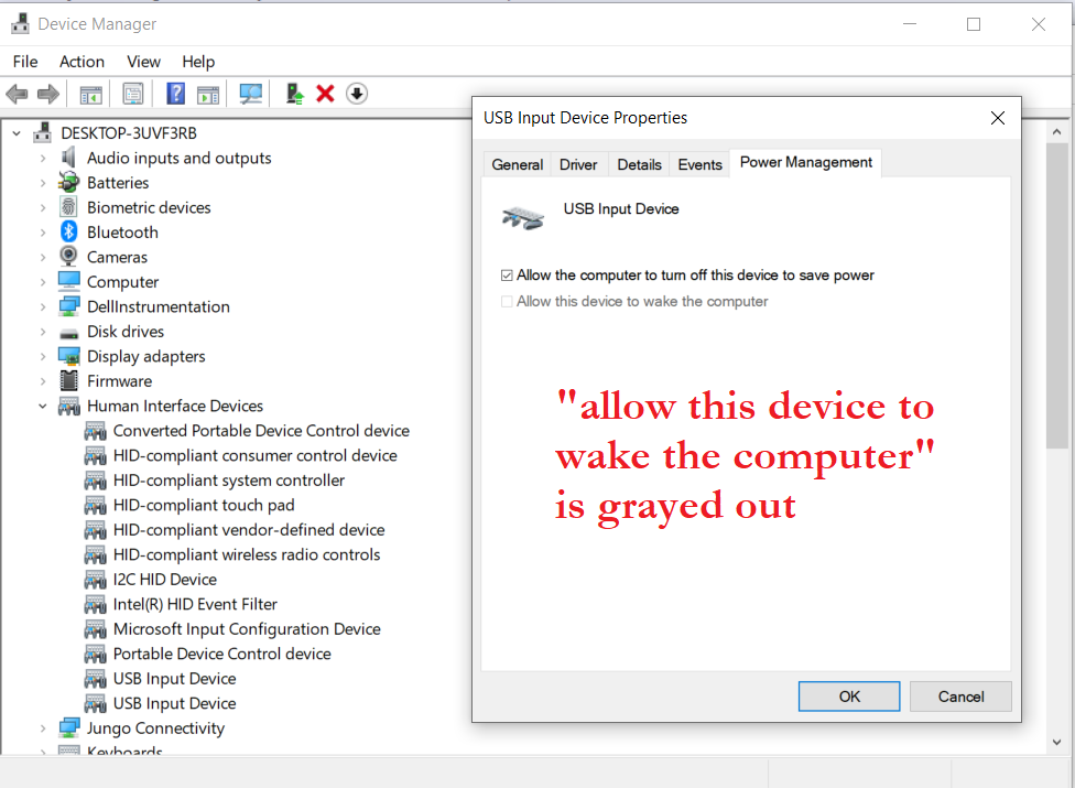

FYI - your suggestion is problematic.  I found that the section for "Allow this device to wake the computer" is grayed out (Windows 10):

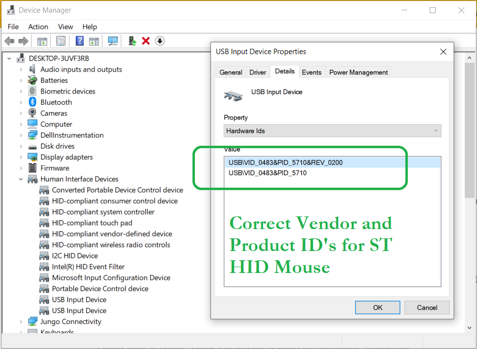

I found this under "Human Interface Devices".  This is the correct vendor and product ID:

Hi @PaulBerland
This feature can be configured in dev_remote_wakeup in USB device desc parameters. FYI, you can find it under usbd_def.h
