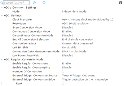

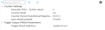

I'm working on a NUCLEO-H743ZI2 Board.
I am attempting to record ADC samples on an SD card using a FreeRTOS CMSIS-V1 program. Below are the configurations for my ADC and Timer6:
ADC Configuration:
Timer6 Configuration, I try to have around a 7500Hz Frequency (APB Timer Clock = 64MHz):
I am acquiring a simple 30Hz sine wave generated with a Low-Frequency Signal Generator. I use HAL_ADC_ConvHalfCpltCallback() and HAL_ADC_ConvCpltCallback() to trigger a TaskNotify(). In my task, if the notification comes from HalfCplt, I write the first half of my adc_buffer (size = 10240) to the SD card. If the notification comes from Cplt, I write the second half of the adc_buffer (ping-pong mechanism).

The topic can be closed, I was actually doing something bad in my writting on SD function.
I also found help in this post: https://community.st.com/t5/stm32-mcus-products/store-adc-s-data-stream-without-losses/td-p/315657/page/2
where it is advised to increase the buffer size to match the sector size.
