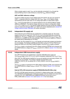

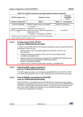

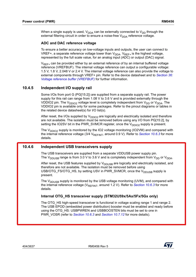

I don't use the 'U5 nor CubeMX, but "stuck in core reset" usually means, that given peripheral does not have clock. In the high-end 'U5 and OTG_HS, setting up clocks is a nontrivial process.
In the 'U5 there are additional obstacles to getting USB going in form of separate power supply pins and their isolation switches.
2 replies
waclawek.jan
waclawek.janBest answer
November 11, 2024

Thanks for your advice, it was helpful, and I was able to solve one of my issues.
By adding a function __HAL_RCC_SYSCFG_CLK_ENABLE() ; in the System Clock Configuration function SystemClock_Config() ; , I was able to exit from the
static HAL_StatusTypeDef USB_CoreReset(USB_OTG_GlobalTypeDef *USBx); function successfully.
