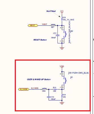

Is STM32F746G-DISCO input button up, down, right, left, or just a push button?
How do I know if the button in the board is just a push button, or also has up,down,right left capabilities?

On STM32F746G-DISCO board, the User button (blue) is only a simply push button not a joystick.
From the board schematics:
This is a symbol of a joystick from another board schematics:
Hope that answers your question

What does the User Manual tell you? And/or the schematics?

Well, the buttons only have a blue and black extension to make them easier to press. Despite the wobbly impression, which is reminiscent of a micro joystick, they are still pure push buttons.
But as @Andrew Neil said: the UM1907 lists them as "Two user and reset push-buttons".
