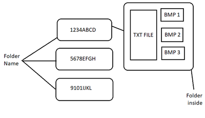

Database look like this .
single folder maximum size will be  3MB (mega byte) and most of the time folder size will be  less than 3MB. Day wise folder will be called  one by one to Display Buffer.
