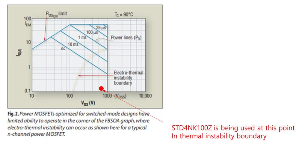

SSONY
SSONYAuthor
August 16, 2022
In addition to above question, I found regarding specific reference applicable to this Linear Operation Mode with DC for general POWER MOSFET (not specified in super junction but all MOSFET)
According to this reference, the linear operation mode with DC is in thermal instability boundary.
This is in accordance with the pointing out that you did. This application is thermally instable.
So, I assume that STD4NK100Z's datasheet doesn't have DC line on the SOA diagram.
and It means this MOSFET was made only for switching application not always ON conditon.
Thus, I really want you to confirm that STD4NK100Z can be used safely for the linear operation mode with DC and DC line can be drawn on the SOA diagram.
I attached original reference about this and indicated the raised operation condition on the SOA in the article
SSONY
SSONYAuthor
August 18, 2022
One more thing I found regarding this operating condition (Linear Mode Operation with DC)
This application is using the lowest Vgs 5V to regulat Id using the principle of source follower.
But, the linear mode operation with low Vgs is under conditon below ZTC (Zero Temperatur Coefficient)
Using low Vgs for long term below ZTC is known as really dangerous condition for MOSFET due to thermal runaway.
I would like you to confirm whether this MOSFET(STD4NK100Z) is all right to be used under this condition.
