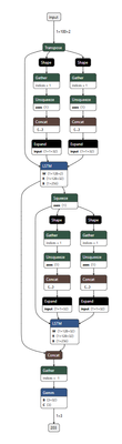

As stated, I have problem analyzing the ONNX model ported from a pytorch model. The code of the model is simple as follows:
class LSTM(nn.Module):
 def __init__(self, input_size, hidden_size, num_layers, num_output=1):
 super(LSTM, self).__init__()
 self.num_layers = num_layers
 self.input_size = input_size
 self.hidden_size = hidden_size
 self.num_output = num_output
 self.lstm = nn.LSTM(input_size=input_size, hidden_size=hidden_size,
 num_layers=num_layers, batch_first=True)
 self.fc = nn.Linear(hidden_size, num_output)
 def forward(self, x, device='cuda'):
 ula, (h_out, _) = self.lstm(x)
 out = self.fc(h_out[-1])
 return out
 Netron vis:
I will really appreciate any advice or workarounds. Thank you!

Hello @Lemanoise,
Can you attach your onnx model in a .zip file please?
In the meantime, make sure you follow the conditions described in the ONNX Toolbox documentation concerning the LSTM:
LSTM
Computes a multi-layer long short-term memory (LSTM) RNN to an input sequence (batch=1, timesteps, features)
  • category: recurrent layer
  • input data types: float32
  • output data types: float32
Specific constraints/recommendations:
  • stateless mode support only
  • fused activation: sigmoid
  • fused recurrent activation: sigmoid
  • return_state not supported
  • Only 1 input is allowed for LSTM; the others should be constant and placed into the initializers
  • layout=1 attribute is not supported
https://stedgeai-dc.st.com/assets/embedded-docs/supported_ops_onnx.html

LemanoiseAuthor
December 13, 2024
Yeah sure, here is the onnx model. Thank you for your advice and I'll look into it as well.

Julian E.
Julian E.Best answer
December 16, 2024
Hi everyone,
I did some test on my side and we currently only support LSTM with 1 hidden size and 1 layer. Something like:
import torch
import torch.nn as nn
# Simple lstm that works
 num_layers=num_layers, batch_first=True, bidirectional=False)
 return out
# If not 1 : error
# other parameter we can put anything
input_size = 10
hidden_size = 1
num_layers = 1
num_output = 10
model = LSTM(input_size, hidden_size, num_layers, num_output)
model.eval()
dummy_input = torch.randn(1, 128, input_size)
onnx_file_path = "simple_lstml.onnx"
torch.onnx.export(model, dummy_input, onnx_file_path,
 input_names=['input'], output_names=['output'])
I tried to stack multiple LSTM but I had no success.
I am asking for more information, I will keep you updated
Have a good day,
Julian
​In order to give better visibility on the answered topics, please click on 'Accept as Solution' on the reply which solved your issue or answered your question.
LemanoiseAuthor
December 16, 2024
Thank you! I have tried the one-layer case and it succeeded. Please keep sharing further information on multi-layer case if any :)

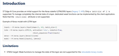

Julian E.
December 16, 2024
Hello  @Lemanoise ,
Using tensorflow, I could use multiple LSTM one after the other (which I did not succeed to do with pytorch).
It may be useful for you:
import tensorflow as tf
from tensorflow.keras.models import Model
from tensorflow.keras.layers import Input, LSTM, Dense
input_layer = Input(shape=(100, 2), batch_size=1)
lstm1= LSTM(32, activation='relu', stateful=True,return_sequences=True)(input_layer)
lstm2 = LSTM(32, activation='relu', stateful=True,return_sequences=True)(lstm1)
output_layer = Dense(units=3, activation='linear')(lstm2)
# Create the model
model = Model(inputs=input_layer, outputs=output_layer)
# Print the model summary
model.summary()
# Compile the model
model.compile(optimizer='adam', loss='mean_squared_error')
model.save('tf_lstm.h5')
Be careful to follow these instructions while using it:
https://stedgeai-dc.st.com/assets/embedded-docs/keras_lstm_stateful.html
Have a good day,
Julian
LemanoiseAuthor
December 18, 2024
Thank you very much!
