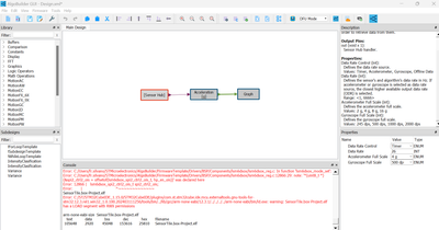

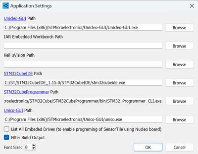

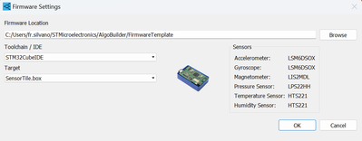

Good morning everyone, I am trying to follow the example for machine learning given for the SensorTile Box
https://github.com/STMicroelectronics/STMems_Machine_Learning_Core/tree/master/configuration_examples/example_2_sensortilebox_algobuilder_unico
with Algobuilder.
I have followed all the steps with the configuration that did not give problems but when I go to compile the project it gives me this sequence of errors and I cannot flash the SensorTile Box.
Firmware Directory Initialization:
Firmware Directories Successfully Initialized!
Code generation finished successfully.
Build Process Started ...
Create.
Opening 'SensorTile.box-Project'.

Error: In function 'bytecpy',
Error: inlined from 'lsm6dsox_mode_set' at C:/Users/fr.silvano/STMicroelectronics/AlgoBuilder/FirmwareTemplate/Drivers/BSP/Components/lsm6dsox/lsm6dsox_reg.c:13376:5:
Error: C:/Users/fr.silvano/STMicroelectronics/AlgoBuilder/FirmwareTemplate/Drivers/BSP/Components/lsm6dsox/lsm6dsox_reg.c:96:13: warning: '*(uint8_t *)(&spi2_ctrl2_ois + offsetof(lsm6dsox_spi2_ctrl2_ois_t, hp_en_ois))' may be used uninitialized [-Wmaybe-uninitialized]
Error: 96 | *target = *source;
Error: | ~~~~~~~~^~~~~~~~~
Error: C:/Users/fr.silvano/STMicroelectronics/AlgoBuilder/FirmwareTemplate/Drivers/BSP/Components/lsm6dsox/lsm6dsox_reg.c: In function 'lsm6dsox_mode_set':
Error: C:/Users/fr.silvano/STMicroelectronics/AlgoBuilder/FirmwareTemplate/Drivers/BSP/Components/lsm6dsox/lsm6dsox_reg.c:12866:29: note: '*(uint8_t *)(&spi2_ctrl2_ois + offsetof(lsm6dsox_spi2_ctrl2_ois_t, hp_en_ois))' was declared here
Error: 12866 | lsm6dsox_spi2_ctrl2_ois_t spi2_ctrl2_ois;
Error: | ^~~~~~~~~~~~~~
SensorTile.box-Project.elf
Error: C:/ST/STM32CubeIDE_1.15.0/STM32CubeIDE/plugins/com.st.stm32cube.ide.mcu.externaltools.gnu-tools-for-stm32.12.3.rel1.win32_1.0.100.202403111256/tools/bin/../lib/gcc/arm-none-eabi/12.3.1/../../../../arm-none-eabi/bin/ld.exe: warning: SensorTile.box-Project.elf has a LOAD segment with RWX permissions
arm-none-eabi-size SensorTile.box-Project.elf
text data bss dec hex filename
105648 2920 45048 153616 25810 SensorTile.box-Project.elf
11:54:15 Build Finished. 0 errors, 3 warnings. (took 2m:35s.373ms)
Build Process Finished
Exit Code: 0
What can I do to resolve this issue?
1 reply
June 20, 2024
Hello @Frabbit
these are not errors but only warnings due to more strict gcc compiler. The binary file is generated and you can program the Sensortile.box.
