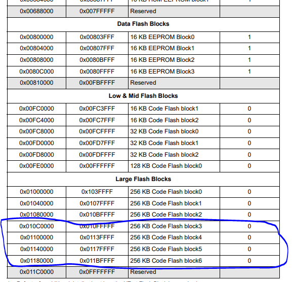

could you show me the memory map of the device SPC584B60E3, what is the exact size of this divice?
  • March 29, 2021
  • 4 replies
  • 1858 views
 I have the memory map on page 76 of this manual,
https://www.st.com/resource/en/reference_manual/dm00400546-spc584bx-32bit-mcu-family-built-on-the-power-architecture-for-automotive-body-electronics-applications-stmicroelectronics.pdf
but it is for 2M flash memory, for my device it is 1M, i have read out the  MCU ID Register #2(SIUL2_MIDR2), one value is 0Xb0004200(1M), but actually i found the flash all be programmed correctly to 2M.

    Parts using the same die, but only portion of it tested.​

    Hi DeLorean,
    thanks for your reply. so do you know for the 1M flash chip, whether the address from 0x010C0000 to 0x011BFFFF should not be included. thanks a lot.0693W000008yF0rQAE.png

    the SPC584B60 has a flash size of 1MB. You can find the details within the related Datasheet at this link, at pag.129 Table 73.
    Regards,
    Luigi
