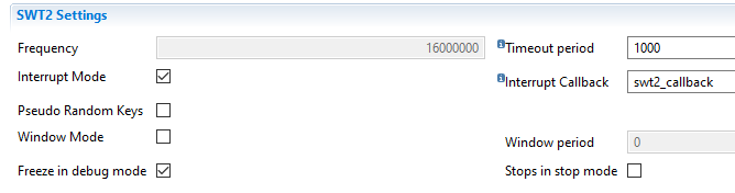

    Hi Olivier,
    I had used same configuration as in the image you shared except SWT0 with timeout period is 5000.
    Thanks!

    then it means you do not use the SWT in pseudo random mode I was suspecting.
    When you say you activate the SWT in you BL code ONLY, I suppose you took example on "SPC58xGxx_RLA SWT Test Application for Discovery" :
    You selected SWT in Low Level Driver component:0693W00000JMf7rQAD.pngIn SWT settings in outline menu, you selected SWT2;0693W00000JMf8uQAD.pngyou configured SWT2 like this:0693W00000JMfAMQA1.png
    Each time you modify demo configuration, you need to clean :
    0693W00000JMfHSQA1.pngand regenerate the sources:
    0693W00000JMfHhQAL.pngbefore to rebuild:
    In your main function, after componentsInit and irqIsrEnable, you started SWT2:
    swt_lld_start(&SWTD3, &swt2_config);
    Did you added this callback in your main.c:
    void swt2_callback(SWTDriver *swtp) {
      swt_lld_keep_alive(swtp);
    And finally, did you stop SWT2 in the timeout callback just before to jump ?
    void stm_timeout_callback(void) {
    swt_lld_stop(&SWTD3);
    updater_jump();
    Regards,
    -Olivier
