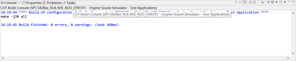

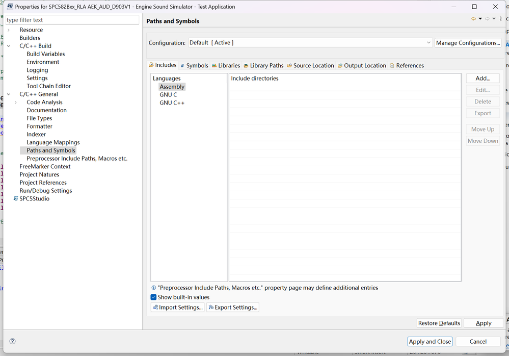

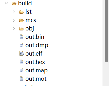

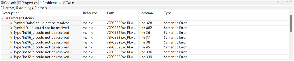

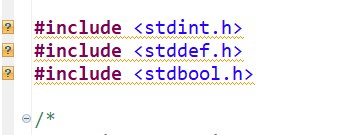

0693W00000WKWlRQAX.pngWhy can't I include the system standard header files? Why can I generate files even if there are problems as long as the console is fine when compiling? Finally, I can burn the program into the chip and run it successfully.0693W00000WKWlHQAX.png0693W00000WKWl2QAH.png0693W00000WKWkxQAH.png0693W00000WKWgbQAH.png0693W00000WKWgWQAX.png

These standard types include are not needed because they are managed internally by SPC5Studio to deal with different compilers and to comply to MISRA rules.
In addition, anything is under the source folder in the project is compiled.
Finally, you can change compiling and linking options from the configuration of the platform.
