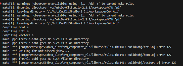

I'm trying to build SPC5 application in VS Studio Code on an agent environment (Windows), which does not have any installed SPC5Studio with Autodevkit plugin. The intention is to start a pipeline on AzureDevOps, where the project can be compiled and build on the agent environment.
While executing the command make -j8 all, I'm getting following error:
I ran this on VS Code with msys64 installed on windows pc.
@Erwan YVIN can you support me on this?
Best answer by Erwan YVIN
Hello ,
The compiler is in an eclipse plugin
Example
c:\SPC5Studio-6.0\eclipse\plugins\com.st.tools.spc5.tools.gnu.gcc.ppcvle.win32_4.9.4.20200908161514\
Autodevkit has the same
you can take it.
we have a linux version too
              Best Regards
                                    Erwan

Hello ,
Example
you can take it.
              Best Regards
                                    Erwan

@Erwan YVIN thanks for the help, by adding eclipse plugin to the path, at least the issue has been solved. But compiling further results in the following error, where build/out.elf is not generated. I tried check the path and even tried to give access to the dir to create files, but no luck. Could you or anyone in community help on this issue or anyone had any idea/hint?

Erwan YVIN
April 24, 2024
Hello ,
which shell (gnu tools) do you use ?
Which version of make do you use ?
i recommend to use git bash or put the gnu tools in your Path (make and so on..)
com.st.tools.spc5.tools.gnu.win32_1.0.0.20210215093711.jar (you can unzip it)
On VsCode , it is very important to create a clean environment ..
(shell , make , compiler ..)
         Best regards
                         Erwan
