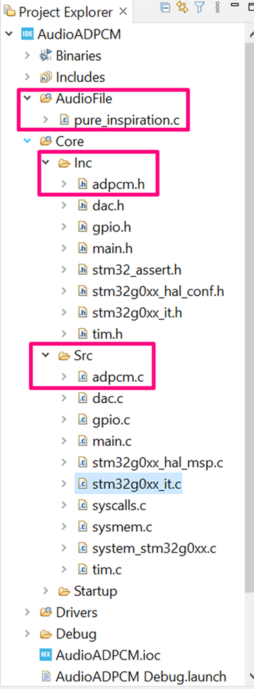

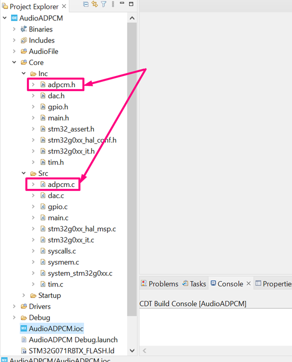

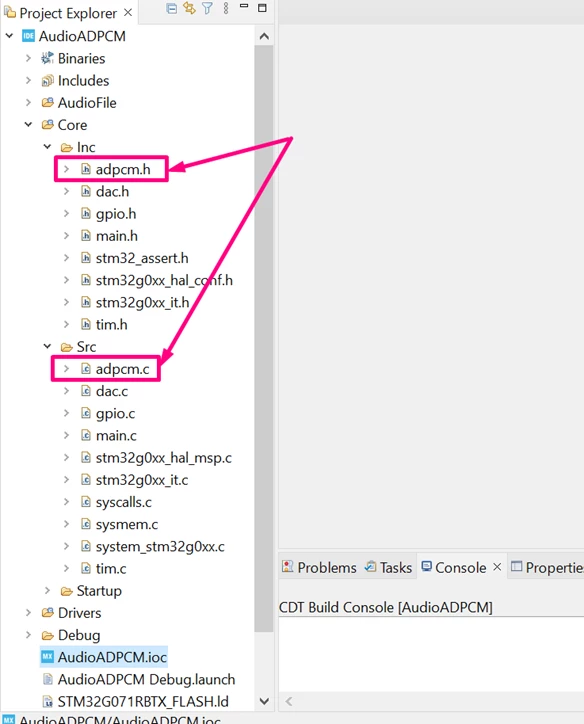

Assuming you have done the previous steps in the part 1 , the files are now created and you will need to manually copy the adpcm.c and adpcm.h from the STSW-STM32022 pack into your STM32CubeIDE project: Core/Src and Core/Inc folders. The result should look like this:
As you might have noticed, in the image above there is also a source folder called “AudioFile”, do not worry, as the next steps will allow us to create it, but a small process for converting a given audio file (WAV format) into a C vector that can be used by our STM32 is needed. So, speaking of the process, this is how ST presented the approach it on the AN4453 that we are using as a reference:

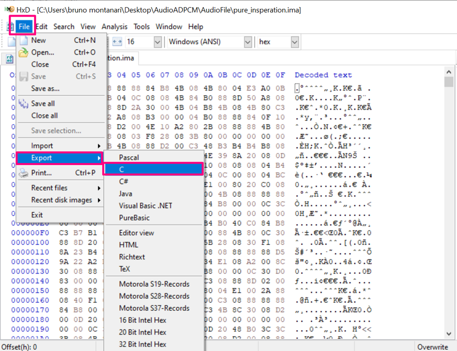

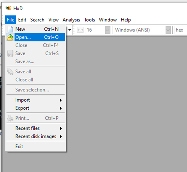

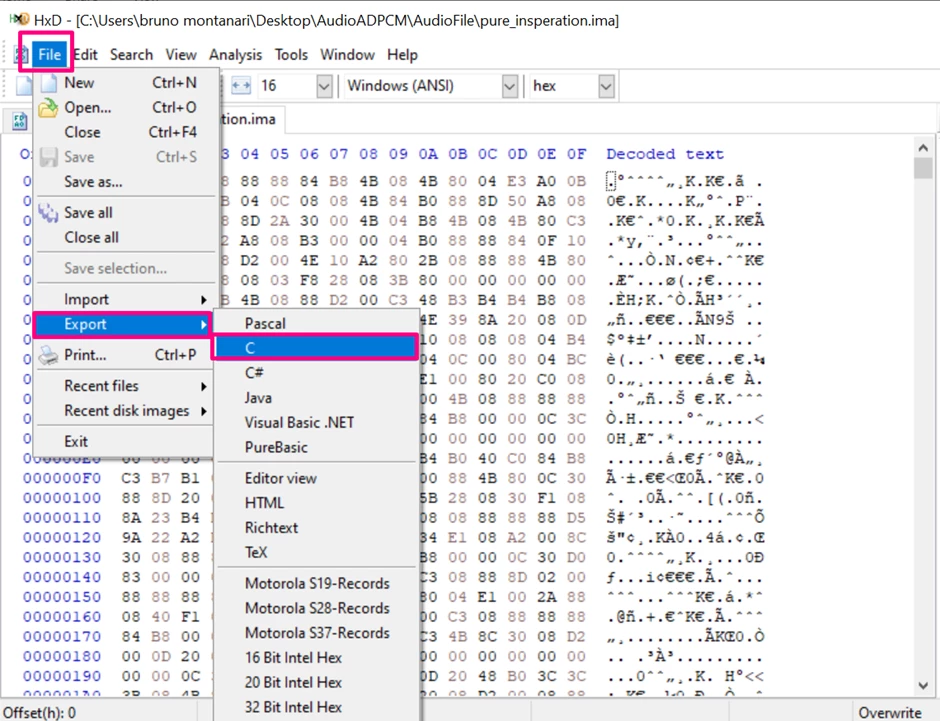

We need another tool called HxD (click here to download it) that can convert IMA into C–it is a GUI interface and it is fairly simple to use. Once installed, go to File->Open: select the *.ima file:
Use File->Export to C.

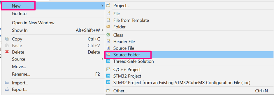

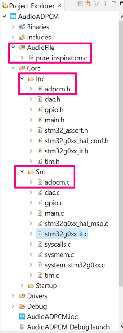

Specify the path you want the file to be placed and done–now we have the C file. With the C file, we can create the source folder and add it inside. By right clicking in the STM32CubeIDE’s project, we can create a source folder by:
Note: if you do not use the “Source Folder”, the STM32CubeIDE will not recognize its content as something to build and your application will fail
Just as a checkpoint, your workspace structure should look like this:

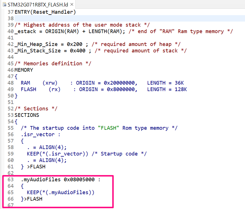

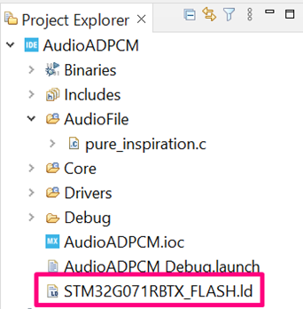

To prepare the FLASH memory section that we need to edit and add this section into the linker file. The linker file is the STM32G071RBTX_FLASH.ld:
Once opened, add the few lines below, this will create a section called “myAudioFiles” in the FLASH memory, located 20KB (0x5000) after the initial code:
As mentioned, this could be replaced by your external memory position, mapped on the linker file.

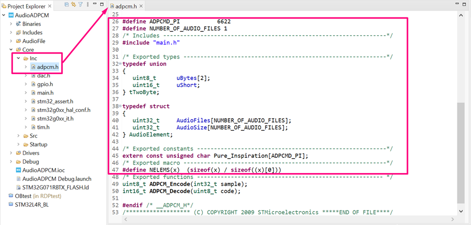

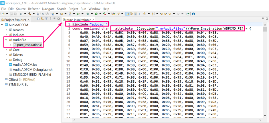

Now, on the audio file, you can use the __attribute__((section(".myAudioFiles"))) to place it in the newly created section. As the C vector file created will be edited, it is suggested to create a define for the size and add this define in the “adpcm.h”, thus adding these modifications:
In the adpcm.h, these small modifications were made to create the defines used previously and to create a structure that will allow multiple files to be loaded.
Note that the #define ADPCMD_PI             6622 should reflect your actual vector size and you can customize the name. As this implementation only deals with a single audio file, the #define NUMBER_OF_AUDIO_FILES 1
