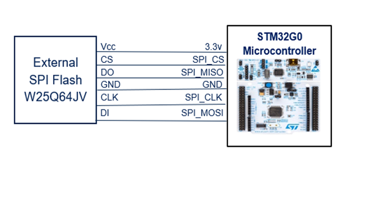

Proto Board - To have the W25Q64JV connected to STM32 through some wires

External SPI Flash memory driver is a piece of code that helps our STM32 microcontroller interact with external memory device through the SPI peripheral.
Before we create the flash driver let us get the SPI peripheral configured on our STM32 microcontroller to communicate with the Flash memory.

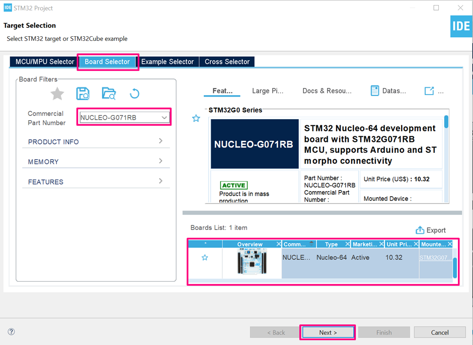

On this Nucleo board, we will use SPI2 peripheral of the STM32G0 to interface with the external memory. Let’s start by creating a new project for the NUCLEO-G071RB – here it is assumed that you already knowhow to create a project using a given board as the default with a quick recap on the steps needed:
  1. Open the STM32CubeIDE
  2. Go to File->New->STM32 Project
  3. Go to the second tab “Board Selector” and type “NUCLEO-G071RB”
  4. Click on the board and then “Next”
      5. Name the project and click Finish
      6. When the pop-up message appears, make sure to accept the peripherals with their defaults

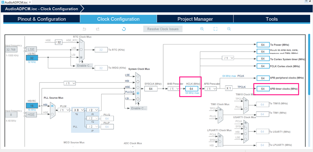

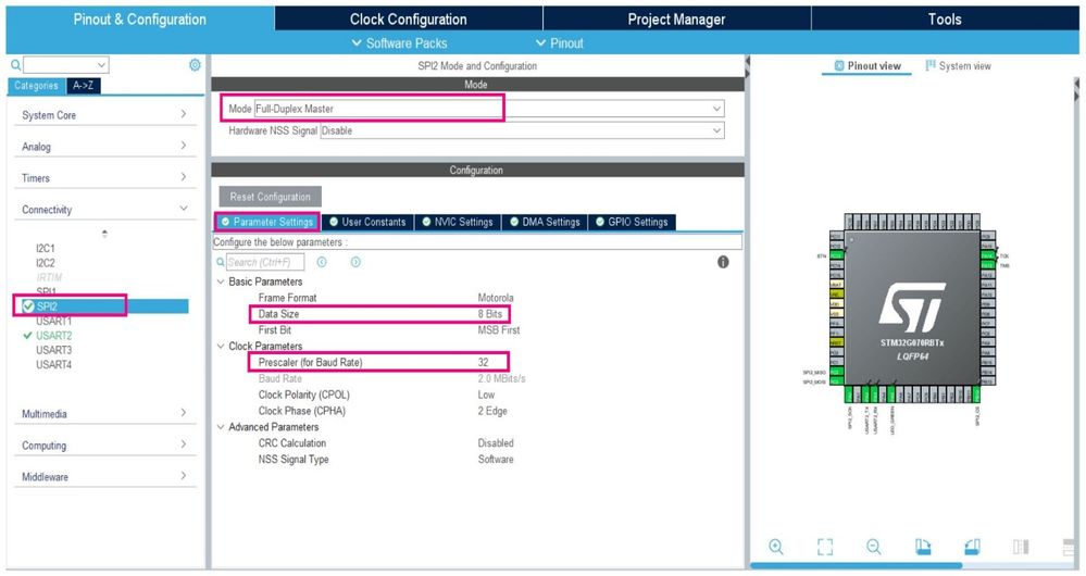

Start by making sure your clock is set as 64MHz, this can be done by going to the “Clock Configuration” tab and asserting the value if needed:

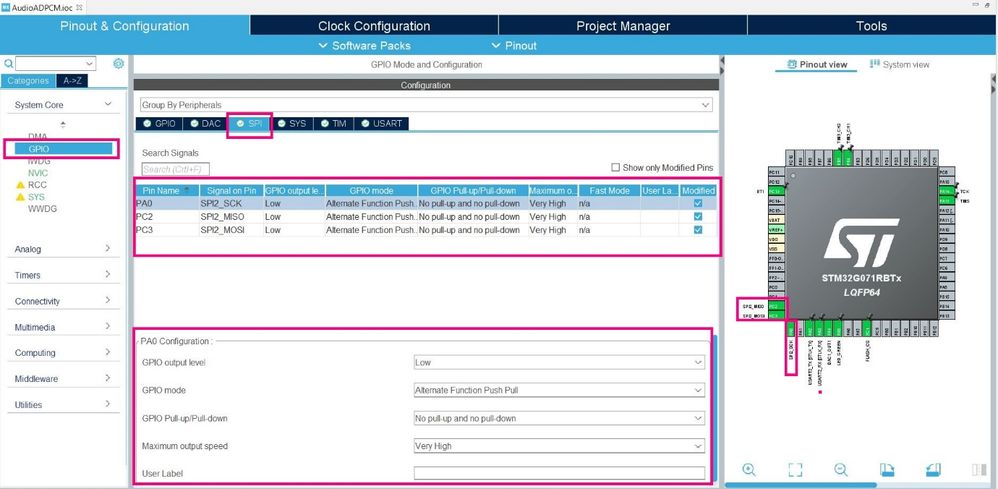

Back to the Pinout & Configuration Tab, let’s configure the SPI2 protocol in Full-Duplex Master mode. With the APB bus clock (PCLK) previously configured to 64 MHz, in order to achieve the Baud rate of 2Mbits/sec, we need to divide the frequency by 32, by setting the prescaler to 32. This sets the SPI clock to 2 MHz. Let us set 8-bits for the  data size, as our external SPI flash memory supports 8- or 16-bit data transfers.
Pin PA0, PC2 and PC3 are used as SPI2 CLK, SPI2 MISO and SPI2 MOSI. Configure their modes in the GPIO tab under System Core as shown above.

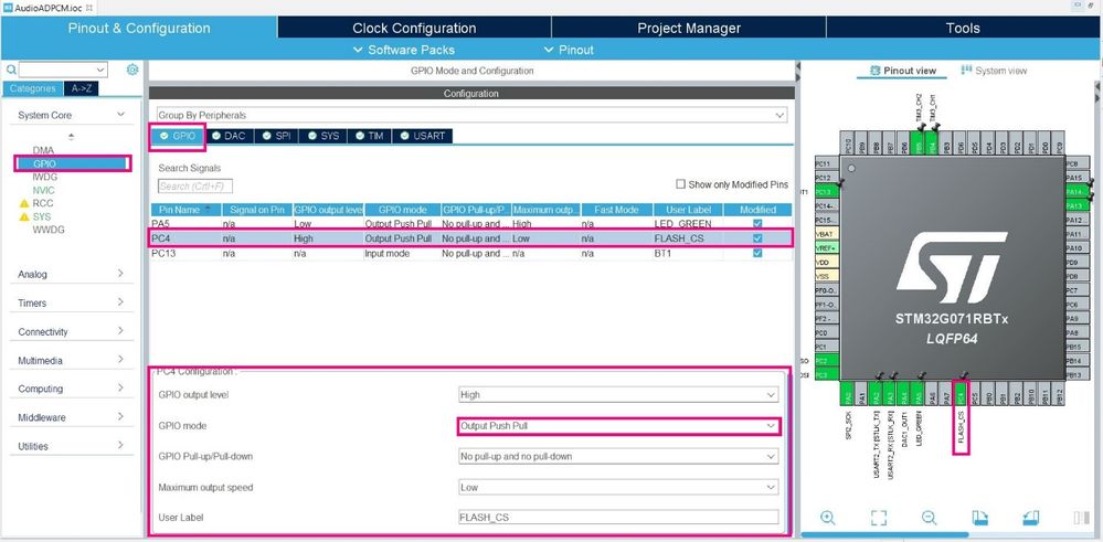

Chip select Configuration:
GPIO pin PC4 is configured as a GPIO Output signal to drive the SPI Flash Chip Select signal.

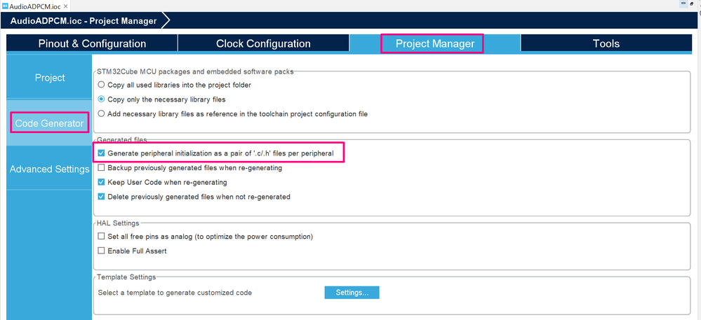

For this implementation, we will use the setting shown below to split the source and header files under Project Manager >  Code Generator:
Now, you are all set to generate your project so either use the short cut “Alt+K” or go to Project->Generate Code
