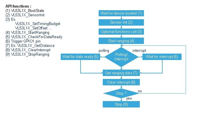

Then I mounted one of the same two VL53L1X-SATEL sensors by interfacing it with the STM8S MCU, using the "VL53L1X ULD API" application package, but here I still have a basic problem that I can't explain.
Before sending the FW used, based on the following flow:
0693W00000Kc552QAB.jpgI would like to briefly describe the defect found in the "VL53L1X_GetInterruptPolarity" function, called within "VL53L1X_CheckForDataReady", in turn called within "VL53L1X_SensorInit".

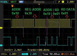

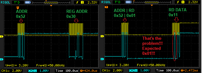

Comparing with the oscilloscope the I2C bytes exchanged in the working case of Arduino UNO and in the non-working case STM8S105, we have the following:
  • Arduino UNO "VL53L1X_GetInterruptPolarity":
  • STM8S105 "VL53L1X_GetInterruptPolarity":
Comparing to Arduino UNO we expect to read the byte 0x01 from the register GPIO_HV_MUX__CTRL, but on STM8S105 we always read 0x11!!!
Due to this problem we have always been stuck inside the function without being able to receive any distance measurement data since dataReady == 0 ALWAYS TRUE !!! (data NEVER READY)

Not entirely sure, but the following worked for us.
The issue was probably with the power drawn by the module. Had to ensure that the VDD was connected to 3.3V supply with enough capacity for 20mA+ current draw.
We had earlier tried to power it off a GPIO pin of the microcontroller and every-time we did that, it did not work and gave dataReady ==0 all the time.
