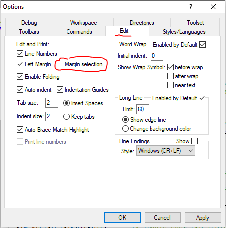

I have recently changed my computer, and reinstall STVD for the development of STM8 applicaiton.using cosmic compiler. In my old computer, I used to set up breakpoint by just double clicking the very left column (where line number appears) at the statement of the source code viewer, and a red dot appears making the breakpoint set. with my new computer, that does not work, clicking the mouse at the left column does not have any effect to set breakpoint. The alternative way is the right click popup and select insert/remove breakpoint.
Is there any one out there having the same problem, and any way in settings to enable this feature?

The STVD Editor's margin features are configurable. In the Tools >> Options >> Edit window uncheck the 'Margin selection' box in order to enable the setting of breakpoints. See the below screenshot and the STVD Manual section 2.7.1 'Customizing editor features'.
Chan.Calvin
Thank you KMath.1, it works.
