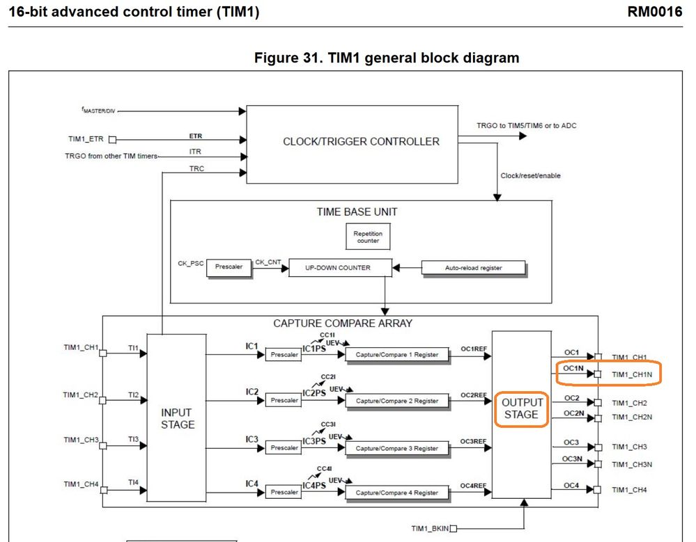

I am using STM8S003F3U.  This MCU is being used with a SPIRIT1 transceiver. Using OOK modulation, the SPIRIT1's raw data is being sent to pin PC3 on the MCU.   Because my transmitter's data rate is inconsistent, I need to be able to measure the pulse HIGH time of the data coming across.  To do this, it is my belief that the following needs to be done:
1) Configure PC3 to its alternative pin function (TIM1_CHANNEL_1_N).  I do not know how to do this.  Can someone provide a code example?
2) Configure the TIM1 capture channel with two ISRs (one for rising edges and one for falling edges), so that the pulse time can be measured.  There is some rudimentary code from ST, but it is unclear how to do this.  Can someone provide a code example?
Once these two steps are complete, I can derive the bit rate and decode messages.  Any help that can be provided is much appreciated!

Are you sure the Negated pin can be used as an Input? I know it can't on the STM32 designs, not sure of the STM8.
The Data Sheet should provide details of the Alternate Function pin mapping options.

Now, thank you for sharing the information that you have.  Regardless of the pin that has been selected - this can be changed quite easily - there is still the need to measuring the PWM pulse time.  If, for example, pin PC5 (TIM2_Channel1) were used and the PWMI Init function were used (see below), how would one extract the pulse time and mange the timer.  If there were any example code for this, it would be useful.

Can an output only pin on the TIM be used as an input? Generally not.

Don't worry about the actual implementation. Instead, think about your approach and then figure out a way to implement it.
Two basic ways to do what you want.
1.use the external pulse train to gate an faster clock. Many ways to do that, for example. The simplest would be to use an interrupt on the input pin to trigger a timer.
This approach can use any pin that's interrupt capable. But it has jitters. Better suited for low speed pulses.
2. Use the capture function of the timer. It is the most accurate, no jitter, but can only be done on certain pins. Great for high speed signals.
You just need to figure out which works better for your application.
