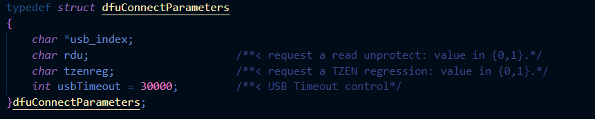

Using connectDfuBootloader in CubeProgrammer_API.dll
MSSloan1962
The callback messages seem corrupt and I get a connection error or -16
2025-12-09 12-05-03.130|INFO||: Type = 0 Message = USB speed : Full Speed (12MBit/s)
2025-12-09 12-05-03.130|INFO||: Type = 0 Message = Manuf. ID :
2025-12-09 12-05-03.130|INFO||: Type = 0 Message = Product ID : STMicroelectronics
2025-12-09 12-05-03.130|INFO||: Type = 0 Message = SN : STM32 BOOTLOADER
2025-12-09 12-05-03.130|INFO||: Type = 0 Message = DFU protocol: 1.1
2025-12-09 12-05-03.130|INFO||: Type = 0 Message = Board : --
2025-12-09 12-05-03.130|INFO||: Type = 0 Message = Device ID : unknown

I'm assuming that each non-working device is reporting the same corruption but different non-working devices give different corruptions but all are giving the connection error -16
1 REPLY 1
Kouthair
Hello there MSSloan1962,
Apologies for the delayed response.
The connection error -16 indicates that RDP is enabled. You can set RDU to 1 to change RDP from Level 1 to Level 0.
You can also find more about the error codes in the CubeProgrammer_API.h file.
Could you please try the official API example or the GUI version and confirm whether they display the correct target information?
