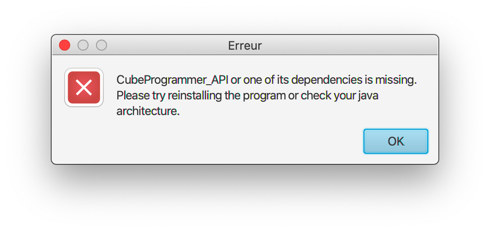

Hi there.
I used your advice to successfully install the application (using the .exe), but then it quite failed.
Starting the app directly (no exe, just the .app) obviously fails. Installer would not output a .exe , which could have been better but i found no way to make it think i was using windows.
I was able to start the application using
/Library/Java/JavaVirtualMachines/jdk1.8.0_202.jdk/Contents/Home/bin/java -jar STM32CubeProgrammer.app/Contents/MacOs/bin/STM32CubeProgrammer
but all i got was this:
Tried various -cp arguments, including all libs and whatevers i could find but was not able to please it. If you have any proposal for a fix, i'll be willing to check and report.
‎2020-09-10 6:05 AM
Hi @fred bar​ ,
Try to launch the command while beeing in CubeProgrammer install folder : STM32CubeProgrammer.app/Contents/MacOs/bin/.
Tell me please if it is OK.
regards,
Houda
‎2020-09-11 10:45 AM
Hi there.
Thanks @Houda GHABRI​ , that worked.
For reference and documentation, i'll include the whole bash solution below for everyone to use simply.
This is for macOS only, by the way and also one would have to adapt to the specific jdk installed.
cd /Applications/STMicroelectronics/STM32Cube/STM32CubeProgrammer/STM32CubeProgrammer.app/Contents/MacOs/bin
Have a great day.
