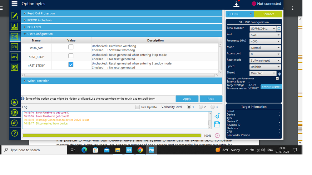

i have tested with stm32f103cx series and stm32f401ccu series . still i watch dog resetting the MCU in standby mode. any idea what is wrong in this.
MMARI.1
Senior II
hi, stm32f401ccu6 datasheet saying that option byte is available to freeze the i-Watchdog . but surprise i-Watchdog is keep on resetting the MCU in standby mode . really where is exact mistake ? Hardware Watch dog or Software Watch dog i have to choose ? . currently i have unchecked box to choose the hardware i-watch dog . and checked box to choose the No reset nRST_STDBY
