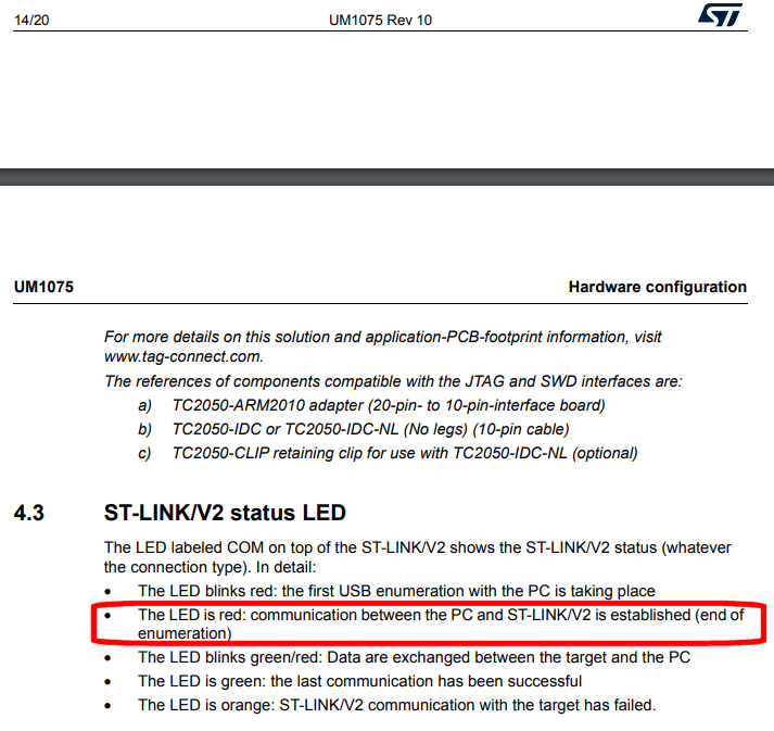

The LED on the top link is red. Is it a problem with the connection or the driver? I can't figure it out. Can you help me?

The meaning of the LED is described in the User Manual:
https://www.st.com/resource/en/user_manual/um1075-stlinkv2-incircuit-debuggerprogrammer-for-stm8-and-stm32-stmicroelectronics.pdf#page=15
So the PC is communicating with the ST-Link, but the ST-Link has not yet had any communication - successful or otherwise - with the Target.
As described in my previous post, your ST-Link can't communicate with your Target because the Target has no power.
The ST-Link can't distinguish this condition from simply having no target connected at all.

That's where you would connect the cable from the ST-Link to you Target.
If you have nothing connected there then, clearly, the ST-Link will not see any Target connected!
In this situation, the Red LED illuminated is the expected condition - as explained earlier.
Have you studied the User Manual?
