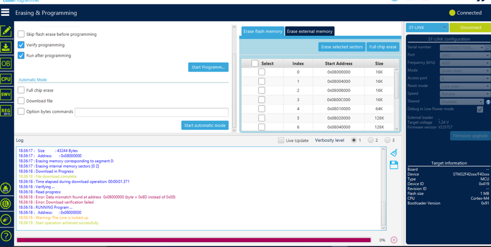

Hello, I am using an STM32F427ZIT6 on a custom board for my project and it was working perfectly until now. I was able to programming it with an ST-Link V2 + ST-Link Utility as expected.
I was working on adding DMA to my code but one day my chip stopped working and I was unable to flash code in it. In fact, I could flash data to the chip but it was flashing it in reverse order MSB LSB instead of LSB MSB.
I tried updating and changing my ST-Link V2. I also tried using another similar board but I did not encounter the same problem. However, I did had strange behavior when flashing my other board (doesn't boot at start address when after power cycle).

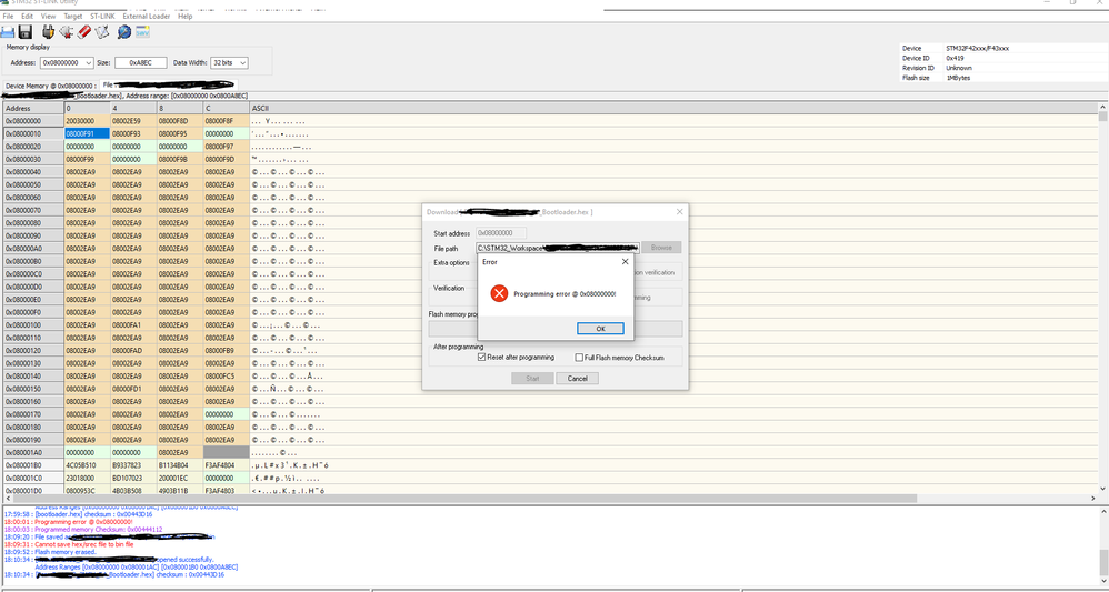

Here is the error message from St-Link Utility (Programming error @ 0x08000000!) :
0693W00000aJfkbQAC.pngHere is the error message from STM32CubeProgrammer (Error: Data mismatch found at address 0x08000000 (byte = 0x8D instead of 0x00)) :

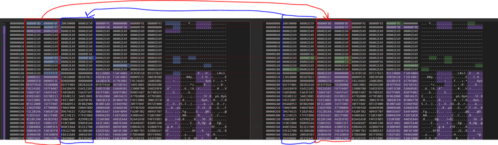

0693W00000aJfl5QAC.pngHere is the difference between the data flashed in the chip and the data from the binary file I tried to flashed. As you can see the data are in reverse order.
0693W00000aJfljQAC.pngCould you please help me understand what is causing this problem and how to solve it.

Not sure how you achieved this.
Perhaps check the Option Bytes / Banking settings
AScha.3
March 24, 2023
jepp. try "erase" everything...mark all memory, erase also all option bytes (just be careful, not touch the RDP level ! ) to get it back to "delivery state" .
if not successful - replace chip.
