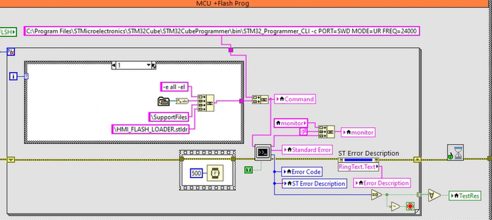

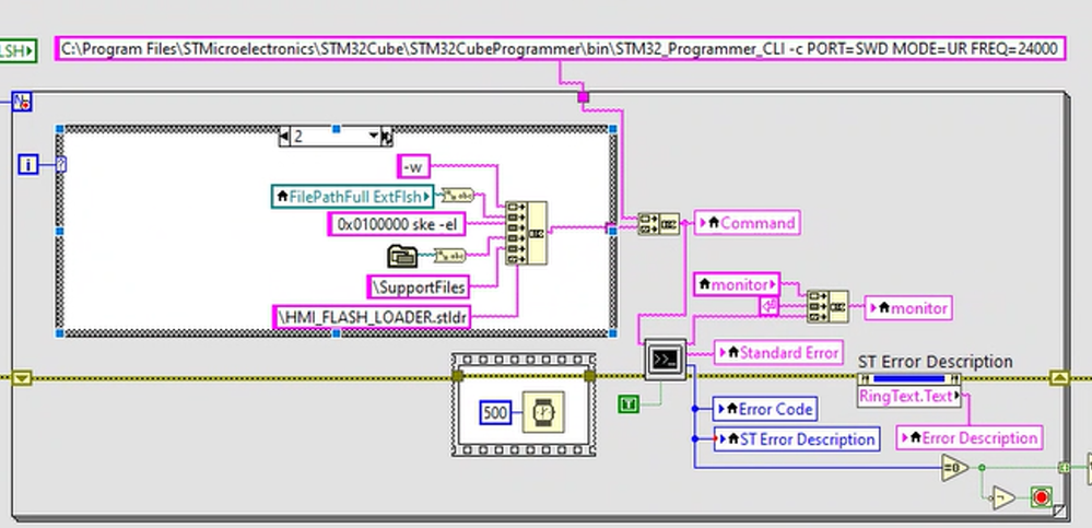

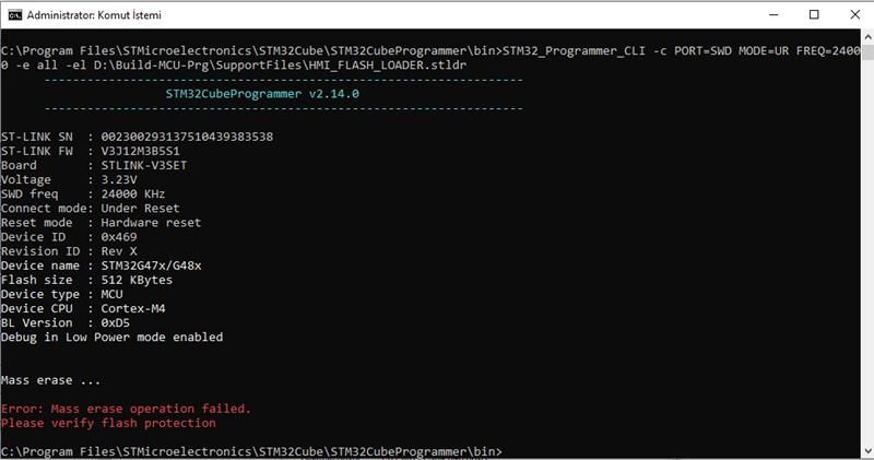

During production, we install external flash and flash software using CLI. We use .stldr file for ext flash update. We were determining that the installation was completed by looking at the return value. However, we have recently seen that installing software on a PCB whose ext flash does not physically exist returns 0. When I run the CLI via cmd, I get the attached error. The return code for this is 1 so the error is obvious. However, when the CLI is run with the computer interface program, the same command returns 0.Manuel Test via CMD
using .stldr with Labview
programming with Labview
