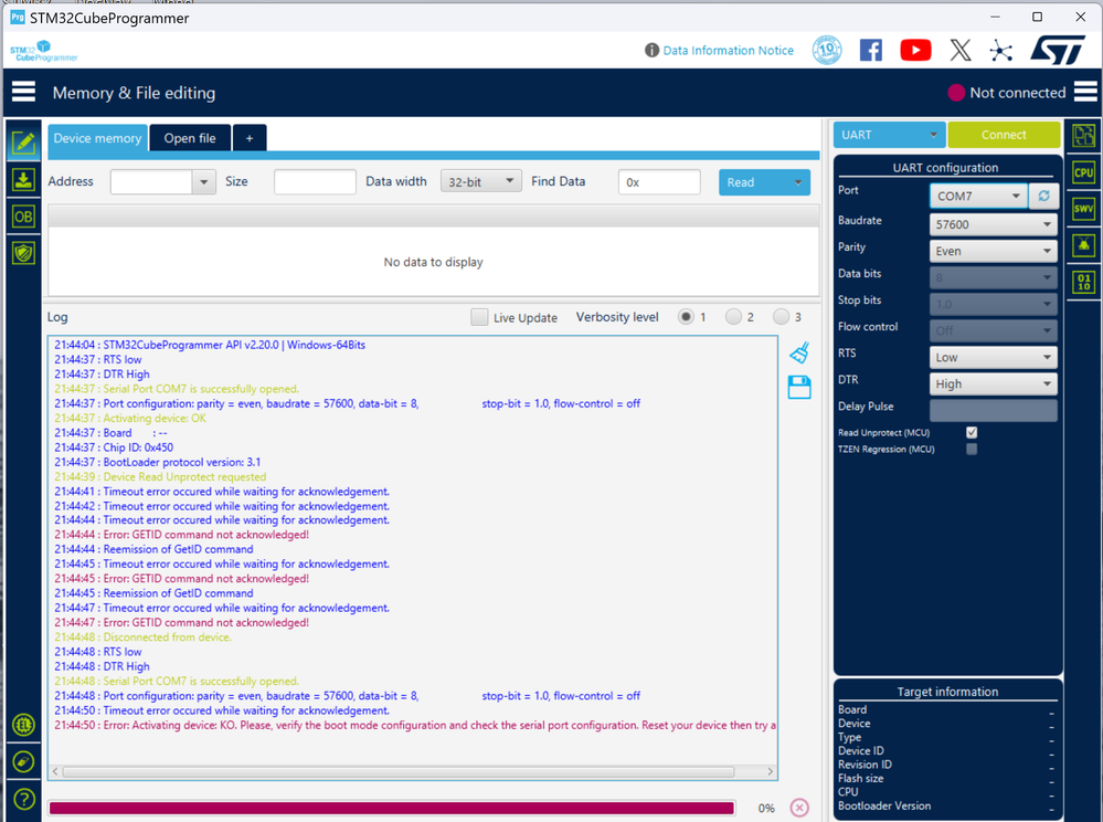

Hello, I'm trying to download the program to the STM32H743VGT6 via the serial port. I keep getting the following error when using STM32CubeProgrammer. Do you have any solutions?屏幕截图 2025-11-03 214547.png

What USART interface and what GPIOs are you using?
Did you refer to the AN2606 section 56 STM32H74xxx/75xxx devices? not all the USARTs instances nor all the USART pins are available for the bootloader.
+ Boot pin = 1 before resetting the chip?
Hello, I used USART1 (PA9 and PA10). During connection, I held down both RST and BOOT0, then released RST first while keeping BOOT0 pressed. However, the aforementioned error consistently occurs.
What board is this?
Has this board ever worked?
Can you connect over SWD?

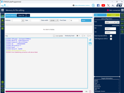

Nothing wrong with what you're doing, so the problem is elsewhere. Some possibilities:
  • Hardware issue (e.g. bad power supply, not powered, miswired)
  • Chip OB set up to ignore BOOT0.
  • Some other bootloader interface is active and takes over before USART1

I try to use the DFU, but the error also consistently occurs.
