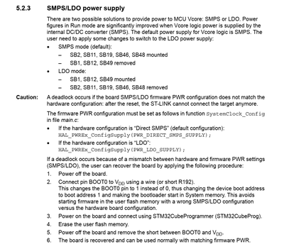

the problem is this BOOT0 in a wrong state probably due to earlier programming, take a look on this paragraph from the user manual
So... in the H747-DISCO board you have to
1. unplug the USB ST-LINK
2. unmount the LCD,
3. short R192 - keep it short circuit
4. plug the USB ST LINK
5. now it boots with BOOT0 = '1'
now you can program,
after program you can put the LCD back
Ofer

The issue might be that the MCU crashes immediately after starting code from the Flash, possibly due to the clock being set too high.
The solution is to avoid booting from Flash (BOOT0 to VDD), then either erase the Flash or write runnable code to it。
