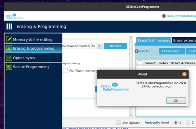

Hoping someone could help.  I did a full erase on the stm32h747i_disco from the stm32cube programmer.  I attempted (several times) to upload the STM32Cube_Demo-STM32H747I-DISCO-V1.0.0_FULL.hex and got the following error:
14:09:58 : Opening and parsing file: STM32Cube_Demo-STM32H747I-DISCO-V1.0.0_FULL.hex
14:09:58 : Memory Programming ...
14:09:58 : File : STM32Cube_Demo-STM32H747I-DISCO-V1.0.0_FULL.hex
14:10:00 : Size : 58.38 MB
14:10:00 : Address : 0x08000000
14:10:00 : Download in Progress:
14:10:04 : Error: failed to download Sector[0]
14:10:04 : Error: failed to download the File
14:10:05 : Memory [0x08000000 : 0x08200000] - Checksum : 0x139CE03C
Does anyone have a suggestion?

Thank you for your quick response.
I am using the v2.20.0 version of the STM32CubeProgrammer.  I have attached as a screen shot.  I have also attached the log file where I attempted to program the board twice.
I am using the Demo Hex file from ST Micro for this board.
Thank you again for your help,
George
Did you enable the flash loader of the external QSPI memory before uploading the hex file??
The part of the graphics in that demo is located in the external memory (QSPI).
Thank you that solved the problem.  Were you able to discover the issue from the log file?
