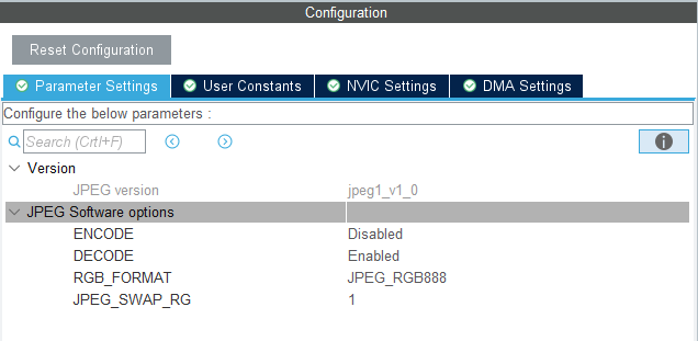

We found a bug while using Hardware JPEG.
Kim KyungTack
The environment I tested is as follows.
IDE: STM32CubeIDE​ 1.5.1
Package: STM32F767II
Package software version: 1.16.1
JPEG settings are as below.
However, there is a typo in the config file that is actually generated.
[ jpeg_utils_conf.h ]

#define JPEG_RGB_FORMAT JPEG_RGB888 /* JPEG_ARGB8888, JPEG_RGB888, JPEG_RGB565 ********* Value different from default value : 0 ********** */
/*  This is the problem.
 * Define JPEG_SWAP_RG
#define JPEG_SWAP_RG 1 /* 0 or 1 */
/* Exported macro ------------------------------------------------------------*/
/* Exported functions ------------------------------------------------------- */
#endif /* __JPEG_UTILS_CONF_H__ */
JPEG_SWAP_RB is correct, not JPEG_SWAP_RG.
For this reason, Red and Blue are not swapable.

Imen.D
Hello @Kim KyungTack ,
Swap RED, and Blue offsets if needs to change the color order by setting: * #define JPEG_SWAP_RB 1
This is mentioned in the AN4996 Application note Hardware JPEG codec peripheral:
Optionally red and blue swap can be selected using the #define JPEG_SWAP_RB (set to 1 to swap red and blue order in pixels)
