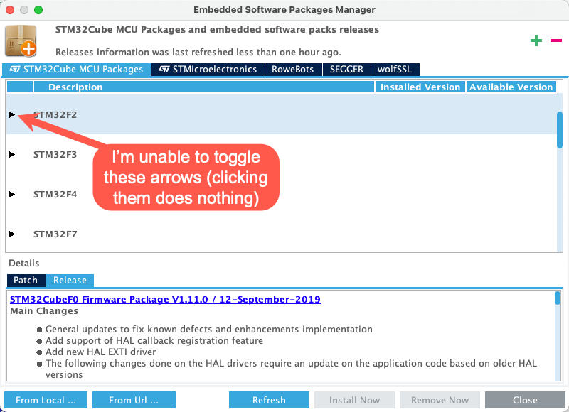

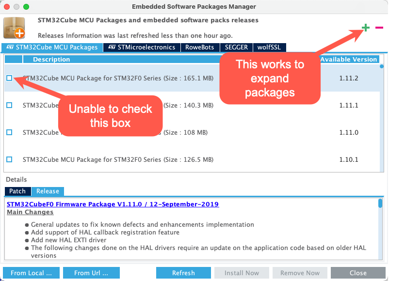

When I open Help -> Manage Embedded Software Packages in STM32CubeIDE 1.8.0, I'm unable to click the arrows to expand the package versions under each STM32 family. If I click the "+" icon in the top right corner, everything expands, but then I'm unable to check any of the boxes next to the packages to select them.

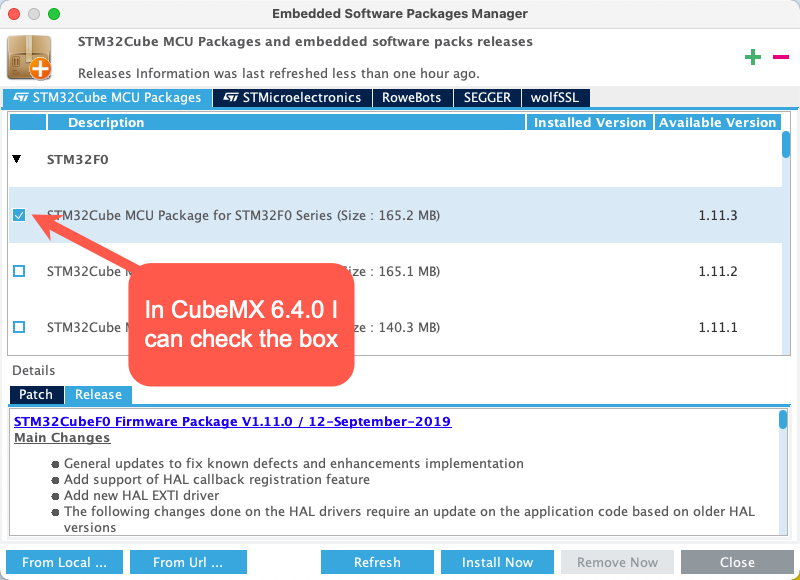

FYI, I do not have any of these problems in the standalone STM32CubeMX 6.4.0:
I'm running this on macOS Monterey 12.2.1 running on Apple Silicon (arm64).

Hi @fcd-chris-1​,
It's a known issue (Related only to macOS).
I propose this Workaround:
Download the Firmware manually form the https://www.st.com/en/microcontrollers-microprocessors/stm32-32-bit-arm-cortex-mcus.html (It should be .zip file) and install it using "From Local..." button from "Manage embedded packages" Window.
We are investigating harder to fix this issue in macOS.

fcd-chris-1
Hi @Aymen CHAKROUN​ thanks for your reply.
I was able to work around this temporarily without having to install "From Local..." by using the STM32CubeMX software to download the firmware. After download, it shows up inside of STM32CubeIDE since they are both using the same Repository directory.
For anyone else coming across this, the more direct link to download the firmware .zip packages is: https://www.st.com/en/embedded-software/stm32cube-mcu-mpu-packages.html#products

Installing it using the STM32CubeMX works, but then I ran into the same problem when I wanted to use the package.
I literally had to click on the expand arrows like a 100 times to get the "Core" row to be showed...

I have found that this problem only occurs for me when the Embedded Software Packages Manager window is open on an external monitor. When I move the window back to the built-in display on my Mac laptop, I am able to expand the arrows and click the checkboxes to install the packages.
