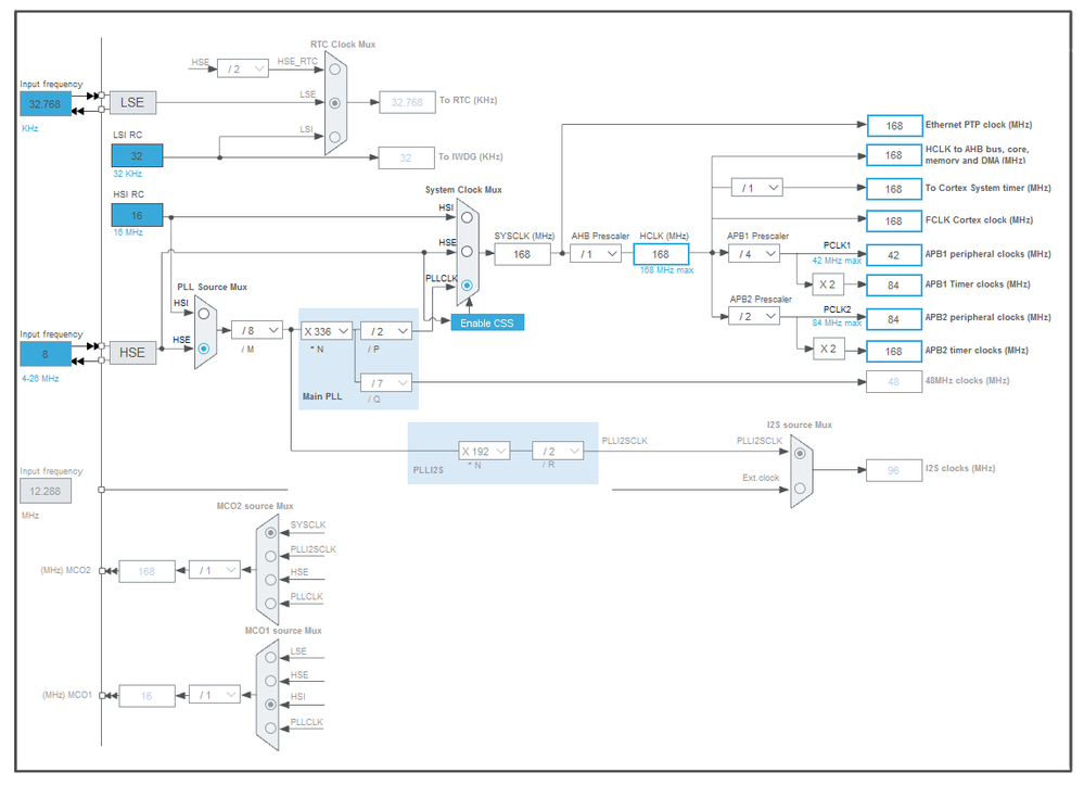

The tools i'm using: STM32CUBEIDE, a scope and an AFG for generating a 5ms pulse each 20ms (50Hz PWM signal on ETR1)
The goal is to start each pwm pulse from the trigger detection with the timer pwm in one pulse mode
Later, I will use the timer trigger ISR to start the ADC
I'm using an STM32f407IGT6 base board with the minimal request and a jtag 5 wires debuging interface
The Combined Reset Trigger Mode option mode does not exist for this device in cubeMX.
So i use the Reset mode with ETR1 as trigger source, pwm generation on channel 2 with the one pulse mode option.
Here is the clock configuration
When i test the code, the CC interrupt has no problem to go in the ISR, the breakpoint was working.
But the trigger ISR is not working.
The TIE bit in DIER register is set and when a falling edge occur on ETR1 pin, the TIF bit is set in the SR register but the programm is no executing the ISR.

> The TIE bit in DIER register is set and when a falling edge occur on ETR1 pin, the TIF bit is set in the SR register but the program is no executing the ISR.
The only other thing needed is to ensure the TIM1_TRG_COM_TIM11_IRQHandler IRQ is enabled in NVIC. Might want to verify that as well, possible it's missed in HAL.
