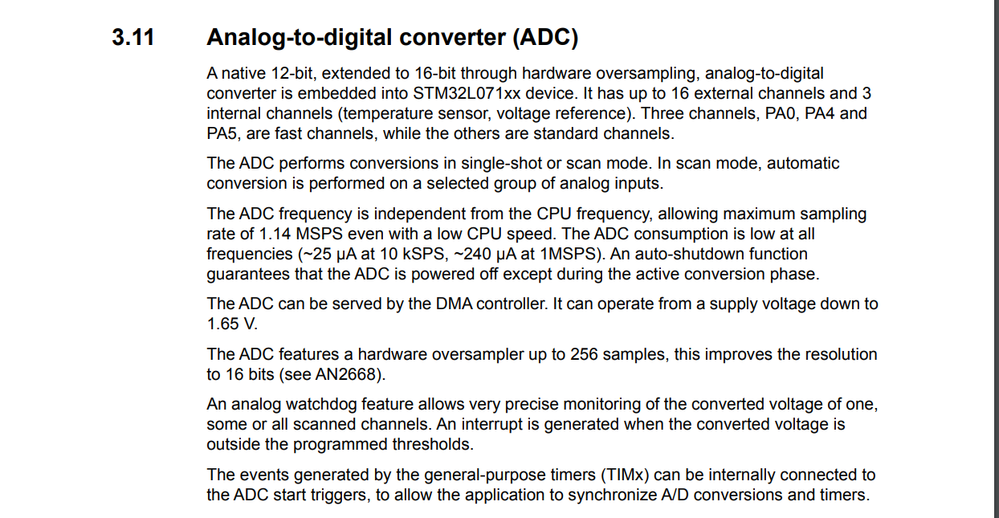

Can you send me a link? The L071 does not have scan conversion mode which is a mode that is usually used when read multiple channels simultaneously
UPDATE:
I have found where they mention scan mode in the documentation of the STM32L071:
However, it wont let me configure this in the cubeMX

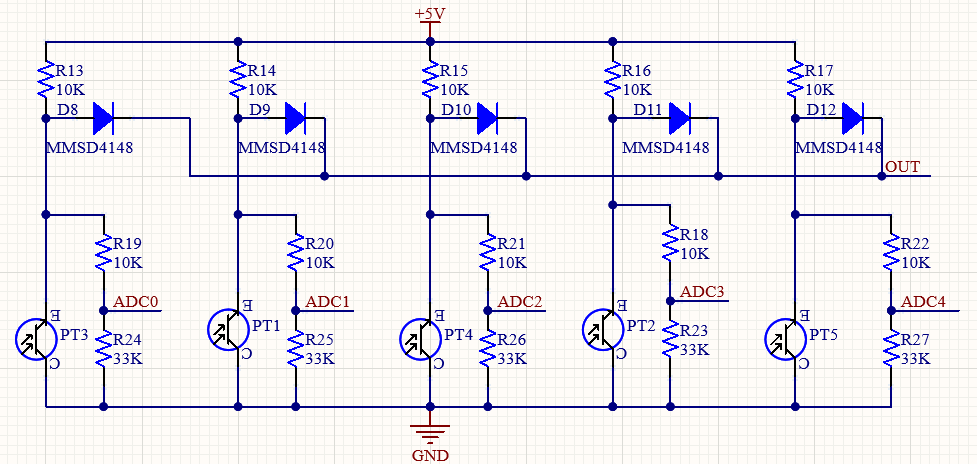

The following is a schematic:

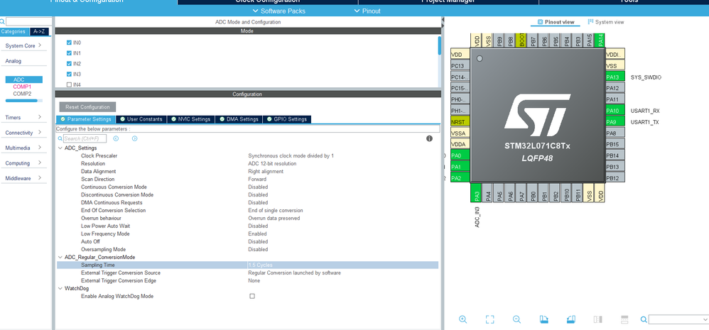

And the cubemx confguration:
I have tried to read multiple channels with the following code: This is just a snipper from a code, I am not inclugind HAL init functions that are irrelevant

The above does not work. When I short the adc0 pin to ground, all other adc readings change as well:

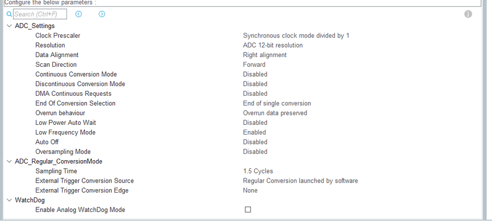

In the cubemx, I should be able to configure my channels as it shown in this example :
However, in my cubemx, I have no such options:
