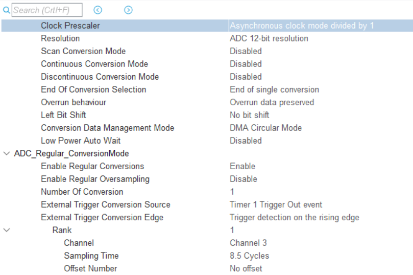

stm32h7b0vb ADC+dma always Overrun Error
  • December 26, 2021
  • 3 replies
  • 1885 views
0693W00000HpnN9QAJ.pngADC Trigger from Timer,DMA transmit ,and then Always Overrun Error, buffer address @0x30000000.Data can not be transferred to buffer correctly,ADC1 register DR is 0x801 while buffer is 0x01.
3 replies
December 26, 2021
Show your code. How fast is TIM1? Are you transferring half words or bytes?

Hello @wjun.1​ ,
Thanks for your feedback,
Could you please specify the CubeMX version and if possible, please share your .ioc file.
Regards,
Sara.
