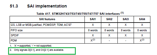

I would like to know how we can configure STM32H7's SAI(s) for 8-PDM microphone inputs (LR * 4 pairs). (16kHz sampling rate).
It seems MX allows us 6 mic with SAI1 and 2 mics with SAI4 but I'm not sure how we can set SAI1/4 exactliy for 8 mics (synchronized data acquisition I want)

Meanwhile, backing to STM32H742, STM32H743/753 and STM32H750 Reference Manual > 51.3 SAI implementation, Table 417. STM32H743/753/745/755/747/757 SAI interfaces, there is a note indicating that SAI1 & SAI4 instances have only up to 3 D input signals. So, these SAI instances can connect up to 6 microphones:
In order to use 8-PDM microphones, you can configure two SAI in PDM mode (One with 6 mic, one with 2).

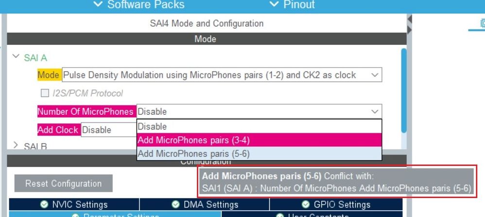

Note that some clock/data pins for the SAI1/SAI4 are shared (taking the STM32H742xI/G STM32H743xI/G devices for example):
  • SAI1_CK1 and SAI4_CK1 are on PE2
  • SAI1_D1 and SAI4_D1 is on PB2, PC1, PD6, PE6
  • SAI1_D2 and SAI4_D2 is on PE4
  • SAI1_D3 and SAI4_D3 is on PC5 and PF10
which unfortunately limits the usability of the SAI-PDM feature.

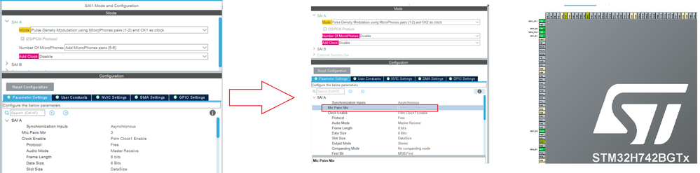

Moreover, a faulty number of microphone pairs will be displayed by STM32CubeMX in SAI4 Configuration Panel > Parameter Settings window tab > SAI A > Mic Pairs Nbr (3 instead of 1), when configuring SAI1-A to "PDM using Microphones pairs(1-2) and CK1 as clock" with a maximum number of Microphones pairs (5-6):
This error in the CubeMX tool will be reported internally to be fixed. I'll keep you posted with the updates.
