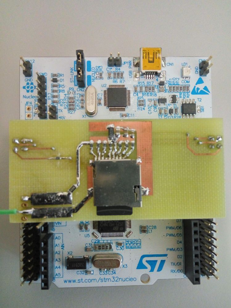

Posted on October 11, 2017 at 03:49
hi,
G..Mario
I am not sure what's the adapter you are using, I just happened to have similar problem recently.
Here is an extension board for F446 Nucleo I made recently.
(Guess it's not well routed....:P)
I use F446 EVAL board schematic as referencefor those pull-up resistors values.
In the end, I found that my tracks are not well routed, and huge power noise is generated.
(Currently working on how to improve it)
Once I lower done the CLK to few MHz ( CLK = SDIO clk/(divide factor + 2) ), then everything works just fine.
Here are some of my experience, hope it helps:
1.Firstly disable file system so that Ican focus on low level driver parts.
2. Disable DMA for the momentand make sure polling mode can work.
3. Lower the clock speed, down to 1MHz or even few hundred kHz.
4. Make sureMX_SDIO_SD_Init() really initialize the sd card from 1 bit mode to 4 bit mode.
5. If initialized ok, try to callGetCardInfo orGetCardStatus.
Good luck!
