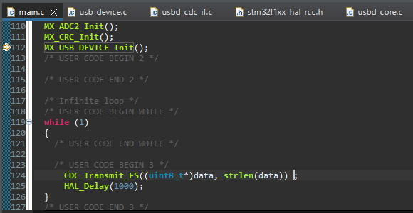

I'm using stm32f103 in my hardware, I didn't put pull-up resistor to USB _ D+ pin.
The device doesnot appear on PC.
_legacyfs_online_stmicro_images_0693W00000bjGtjQAE.pngIs there any way to make it work without Hardware changes?
AScha.3
>Is there any way to make it work?
yes.
add 1k5 pull-up resistor to USB _ D+ pin. - without 1k5 , no enumeration.
you edit :
no.

Also, generally, if you call Transmit from the main loop, the USB will sooner or later hang.
