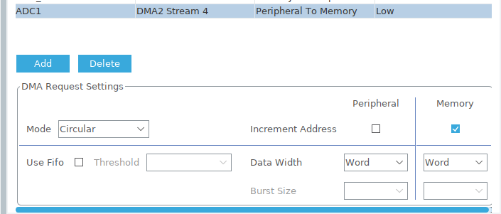

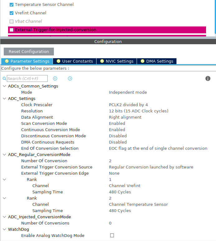

I'm trying to configure my project with STM32CubeIde 1.2.1
I want to use ADC1 to perform temperature and vrefint measurement.
So I configure my adc & dma :
But I'm not enable in cube to enable the DMA option, only disable is possible.
If I enable the flag manually in the code generated, I don't have any problem and the code is running as expected (continuous acquisition of both channel with an interrupt each time the acquisition is complete)
Is there a reason this option isn't possible in cube ?

More infos, I don't have this problem on a clean/empty project
‎2020-02-06 2:19 AM
​Hello @Community member​
Could you please give me more details (scenario) and share your project (where did you find issue)?
Thanks,
Khouloud
‎2020-02-06 2:50 AM
‎2020-02-06 5:15 AM
​Issue will be fixed in the next release.
