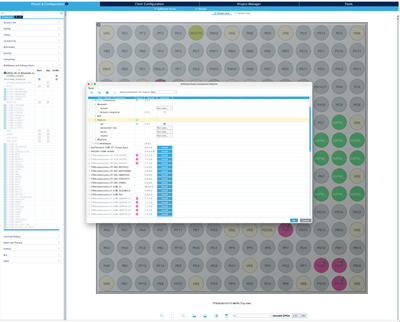

I am running into thread exception while running CubeMx on MacOs M4 Pro.
Platform: MacOs M4 Pro
CubeMx (About):  Java (21.0.8 (9))  [STM32CubeMX 6.16.0 Mac ARM]
When I try to open Airoc-Wi-Fi-Bluetooth Pack under Middleware, I get following exception and call stack.

 Scrrenshot of what I am clicking on :
Is this normal ?

JenishR
Please check the video below to see the issue in Practice...
https://youtu.be/4XAnbo0Q9g0
