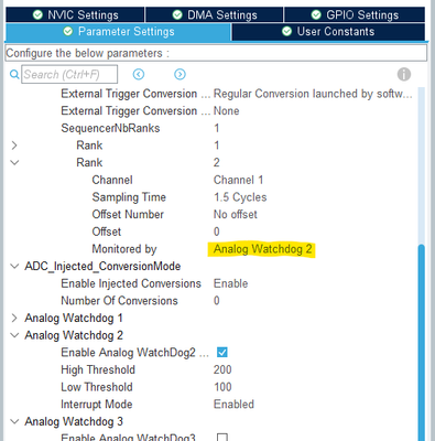

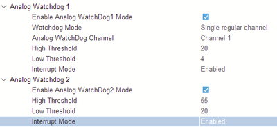

The first watchdog successfully generates
  /** Configure Analog WatchDog 1
  AnalogWDGConfig.WatchdogNumber = ADC_ANALOGWATCHDOG_1;
  AnalogWDGConfig.WatchdogMode = ADC_ANALOGWATCHDOG_SINGLE_REG;
  AnalogWDGConfig.HighThreshold = 20;
  AnalogWDGConfig.LowThreshold = 4;
  AnalogWDGConfig.Channel = ADC_CHANNEL_1;
  AnalogWDGConfig.ITMode = ENABLE;
  if (HAL_ADC_AnalogWDGConfig(&hadc1, &AnalogWDGConfig) != HAL_OK)
    Error_Handler();
The second watchdog generates... nothing. When I write out similar code myself for the second watchdog then it starts working. The IOC interface looks like

Did you enable it?

Hello @avidroneg
Could you share an ioc in order to further investigate the problem.

Thanks very much; that was the issue. I didn't see that "rank" can expand.
