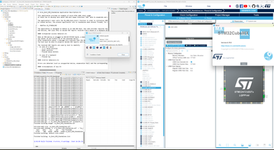

I've been trying to build example projects (i.e. Ux_Host_HID) with the make tool chain config with stm32cubeMX

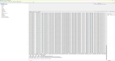

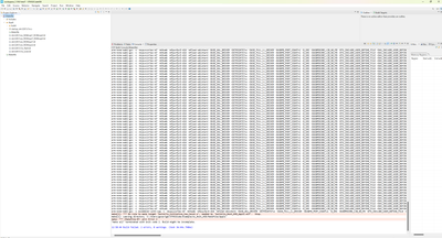

So when i run make, a bunch of stuff compiles, then i get this error.
make: *** No rule to make target 'build/tx_initialize_low_level.o', needed by 'build/Ux_Host_HID.elf'.  Stop.
So when I search for that tx_initialize_low_level I find a .s assembly file in  Ux_Host/Core.Src
Also, the make file seems to already be looking for assembly files to create the .o but for some reason, make is not recognizing it has a valid rule.

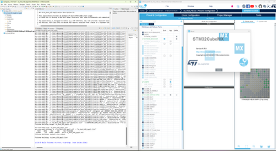

I'm using STM32CubeMX (6.15.0) and compiling those generated files in cmd
line with make
I think there is an issue with the auto-generated makefile. Its not picking
up the assembly files in
/STM32Cube/Example/Ux_Host_HID/Middlewares/ST/threadx/ports/cortex_m7/gnu/src/
I've found a solution by copying those files in the top directory
