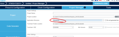

Hi @TDK,
Do you know how I can toggle between "Advanced" and "Basic" application structure? In my CubeMX, that option is unhigh-lighted and I can't change from "Advanced" to "Basic".
After you generate code, it is locked and can no longer be changed to avoid user code and other files being deleted unintentionally.
To change it, do a Save As on the IOC and it will be available again or manually edit the IOC file. Back up your files first--switching mid-project is not a supported use case.
