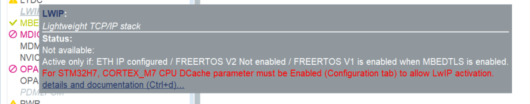

I'm attempting to experiment with my STM32H743 NUCLEO board and CubeMX 5.2.1 does not allow me to add LWIP Middleware. How do I use the boards provided TCP/IP network without lwIP?
TBibe
From STM32 CubeMX 5.2.1 release, the LWIP is grey'd out. What am I missing to include this?
Khouloud ZEMMELI
​Hi @Community member​ ,
If you want to activate LWIP , you need to enbale :
1- ETH
2-FreeRTOS V1
3-MBEDTLS
4-CORTEX_M7 CPU DCache (only for H7)
see attached note

Khouloud ZEMMELI
1- ETH
2-FreeRTOS V1
3-MBEDTLS
see attached note
Best Regards,
