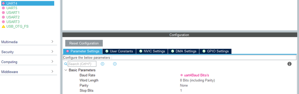

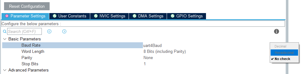

To configure my uart baud rate i use a variable on cube MX. To disable error i select "no check" in option --> that work find on previous version.
Now with version 6.1.1 the error stay even if i select "no check" with the version 6.1.1.
If you have an idea how to solve it !

Hi @MLE S.1​ ,
You need to declare all your variable in user constants and you can set your custom baud rate in the constants value.
Thanks!
Houssem

‎2020-12-21 3:34 AM
Thanks @Houssem CHAABANI​ for your rapid answer
Problem solved : just need to declare uart4Baud in user Constants to solve the problem !
