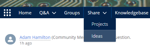

Thanks for sharing your ideas. This forum is a good place for it, and we will have a look to it, but maybe you can also duplicate your post
in the IdeaZone, in the menu Share->Ideas
