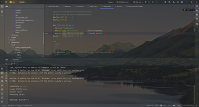

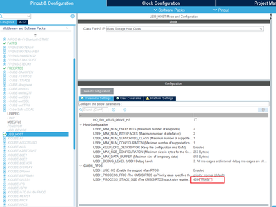

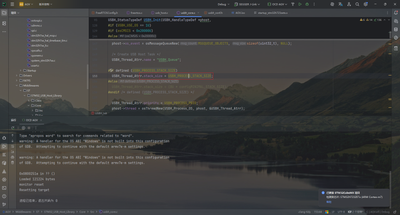

在32位中,字的单位应该要*4吧?为什么这里直接是按字节赋值???坑死我了

The user must be aware that the macro is defined in words. In this case you should use it as a value in words and convert it to bytes when required. For example, in definition of defaultTask in main.c the stack size is multiplied by 4to convert it from words to bytes.
