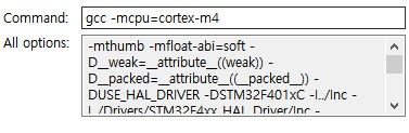

So, I added the "-mcpu=cortex-m4" option and compile again.
But following error is listed end of compile, maybe link time
make: *** No rule to make target 'RCS/../', needed by '../'. Stop.

paul0208
my compiler is gcc and option as this:
this option are generated by CubeMX except -mcpu option

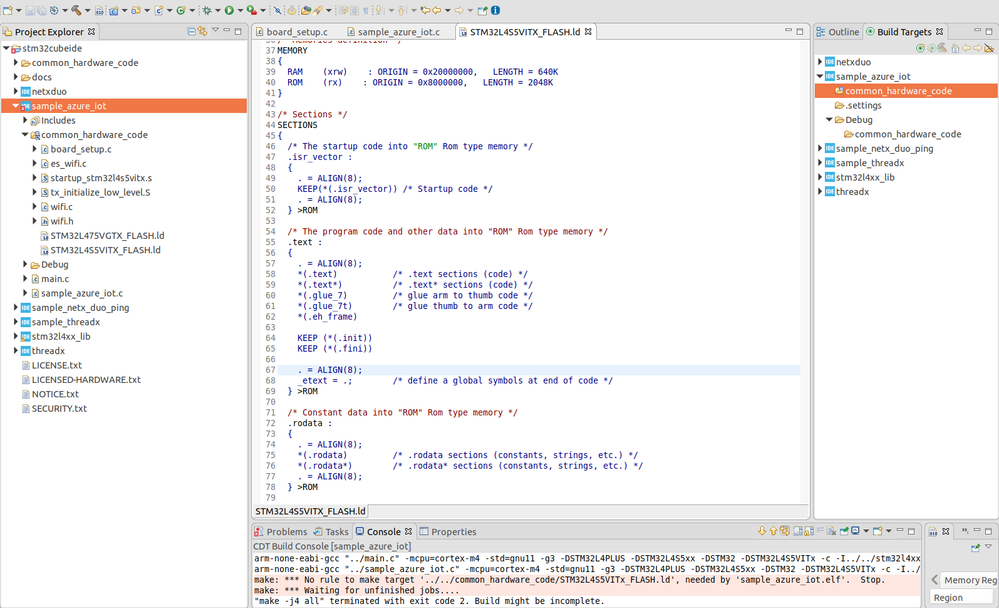

solarflarefx
I am trying to run the sample_azure_iot project and get this same error in stm32cubeide. Any idea what could be wrong? I downloaded the sample directly from: https://github.com/azure-rtos/samples
