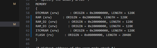

Hello @Mahmoud Ben Romdhane
After I enable the switch.
The ld file regenerate as below.
It seems not right.
Thanks,
Hooper
