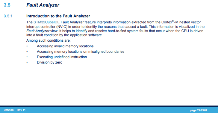

The code looks OK. Debug as usual. HardFault where? The debugger of CubeIDE has convenient tool to analyze HardFaults.
Andrew Neil
So where, exactly, does the Hard Fault occur?
And what Fault is reported?
Some links here on debugging Cortex-M Hard Faults:
https://community.arm.com/support-forums/f/embedded-forum/3257/debugging-a-cortex-m0-hard-fault
See also CubeIDE Fault Analyser:
https://www.st.com/resource/en/user_manual/um2609-stm32cubeide-user-guide-stmicroelectronics.pdf
