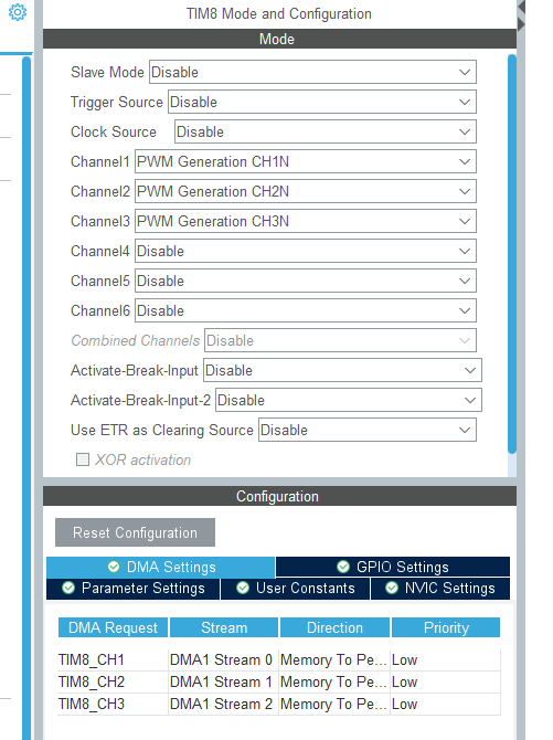

When generating Code for STM32H753IIKx I recently stumbled across unexpected behaviour in Cube IDE V1.5.0. I'm using the processor Pins PH13-PH15 in order to output a PWM Signal from the N-Outputs of Timer 8 (CH1N1-3). However no correlating signals were observed.
My timer initialization:

Cube IDE Setting:
Further investigation showed, that registers for controlling the driver stage were not set accordingly in the peripheral. Only the complementary outputs of the PWM stage were enabled (CH1-3).
Writing to the registers manually later on (outside of the auto-generated codeblock) solved the issue:
htim8.Instance->CCER = (1UL << 2) | (1UL << 6) | (1UL << 10);
Is this a bug or are there underlying mechanics which I'm not realizing?

If I well catch, you want only negative or positive + negatiev to control 6 mosfets with dead time? If second, you ahve to enable them in CubeMX.
‎2021-02-05 12:22 AM
The timer is not used for any kind of bridge,... where dead time would be required. We just have a PCB where a RGB LED is routed to the PWM Pins. R, G and B to one Timer channel Pin. Not a huge deal, but I was just wondering what might be wrong here.

* @brief Enables or disables the TIM Capture Compare Channel xN.
* @param TIMx to select the TIM peripheral
* @param Channel: specifies the TIM Channel
* This parameter can be one of the following values:
* @arg TIM_Channel_1: TIM Channel 1
* @arg TIM_Channel_2: TIM Channel 2
* @arg TIM_Channel_3: TIM Channel 3
* @param ChannelNState: specifies the TIM Channel CCxNE bit new state.
* This parameter can be: TIM_CCxN_ENABLE or TIM_CCxN_Disable.
* @retval None
static void TIM_CCxNChannelCmd(TIM_TypeDef* TIMx, uint32_t Channel, uint32_t ChannelNState)
That's quoting from STM32Cube_FW_H7_V1.3.0\Drivers\STM32H7xx_HAL_Driver\Src\stm32h7xx_hal_tim_ex.c . I don't Cube at all, so don't know if this can be somehow clicked in CubeMX.
