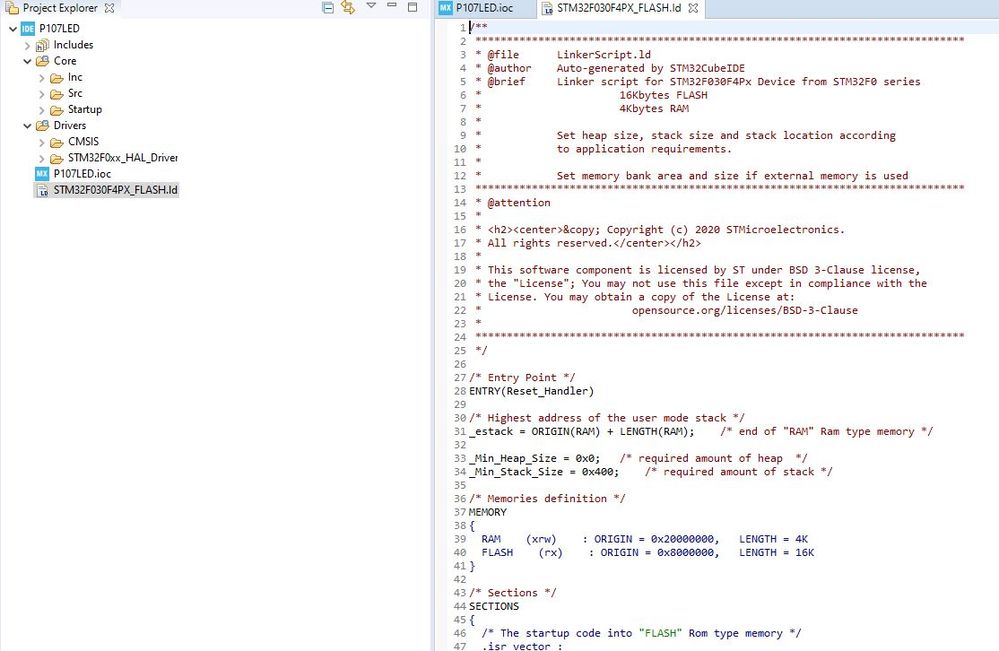

Problem one: The file STM32F030F3Px_FLASH.ld was never created in my project, so I found one online and put it into my project folder
Problem two: The linker argument builder is not able to resolve the ${workspace_loc:/${ProjName}/STM32F030F4PX_FLASH.ld} path, so no -T "c:\foo\bar\STM32F030F4PX_FLASH.ld" is added to the linker command-line.
Work-around for problem two:
Added under other flags for the linker: -T "${workspace_loc:/${ProjName}/STM32F030F4PX_FLASH.ld}" - The quatation marks are important, else \ for windows paths turns into escape characters...

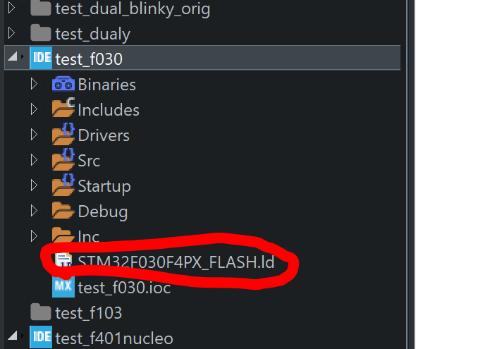

I just tried this. Linker file is generated just fine. Same OS and software versions as you (but English locale).

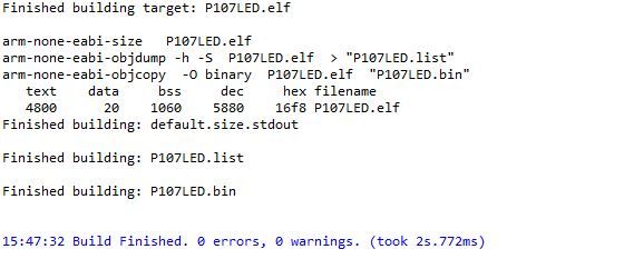

After some studying of the result .ELF file with arm-none-eabi-objdump, I saw that the entire .code and .data sections were mapped into 0x8000.
Then I noticed that there was no linker script in the project folder, so I added that manually
But it still was not used, no -T argument used for linking, so added the -T argument manually, and finally I had a working binary that does give assertions in openOCD or disconnect errors with STLINK tools.
Got linker file without issue from your .ioc file (IDE 1.3.1)
I've done my trial based on File > New > STM32 project from .ioc file
Project compiles without any issue

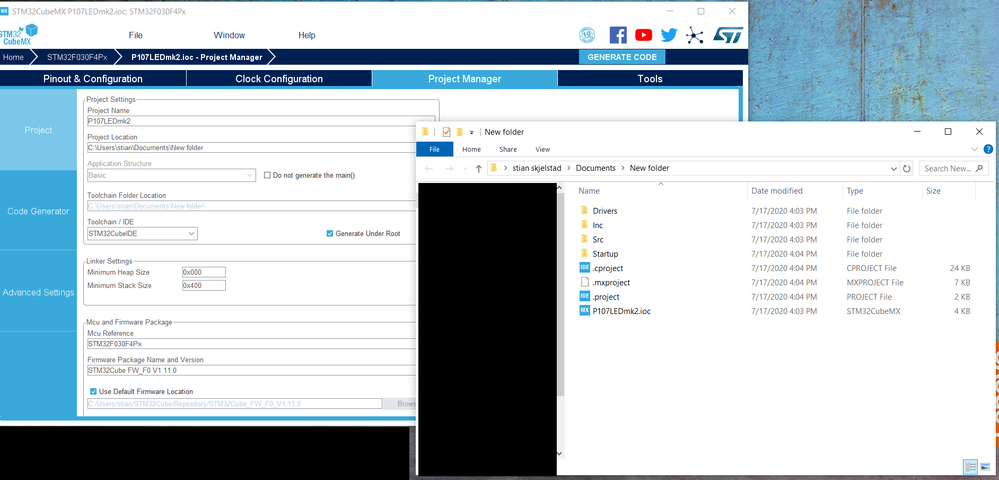

So you generated the project inside STMCubeIDE, not inside STMCubeMX?
I just tested. I renamed the file into mk2, opened it in STM32CubeMX and hit generate code, and then "open folder"0693W000001t7ZHQAY.png

According your snapshot you're right if MX standalone sounds you're lacking linker file ... quite weird. Which MX version are you relying on ?
Just in case looking in details at your snapshot ... could be issue the fact you'have set 0x000 as heap size ? I would guess such is preventing linker file generation ...
As specified in the initial post: STM32CubeMX: 5.6.1 (and yes, problem is generate project from MX, not import/create from inside the IDE itself)
