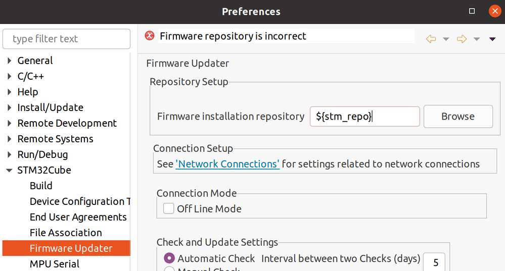

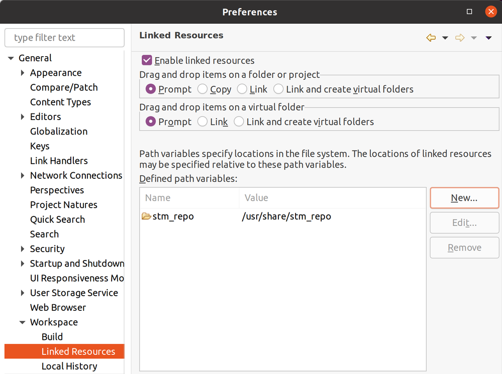

1. Create a symlink to the stm repo:
sudo ln -s ~/STM32Cube/Repository /usr/share/stm_repo
2. Add this as a path variable in "Window > Preferences > General > Workspace > Linked Resources"
3. Use this path variable for the firmware repo in "Window > Preferences > STM32Cube > Firmware Updater".
Unfortunately, I can't figure out how to just use the "stm_repo" variable, and must instead use "/user/share/stm_repo".

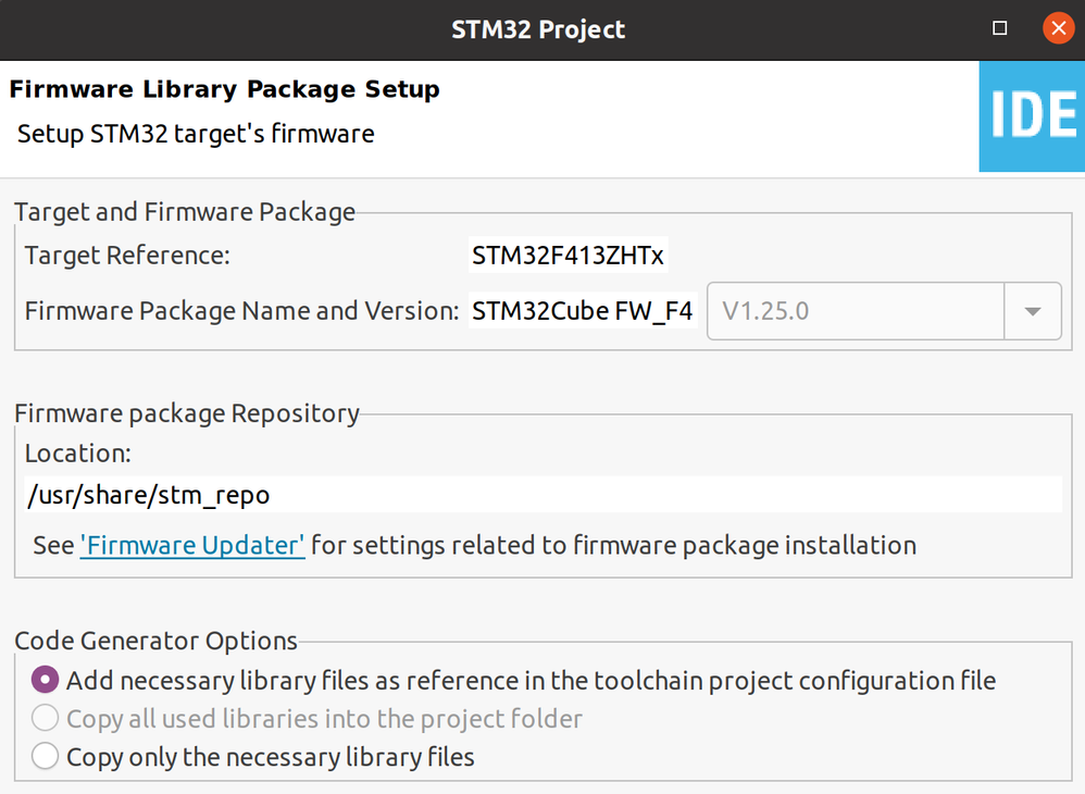

4. Create a new project. It will point to the same path set in the firmware updater.
Unfortunately, there are still lots of paths hardcoded for my machine in this project:

Yes, you've shown definition of path variables at workspace level.
I prefer to define them at project level because then they go into the .project file and to version control.
