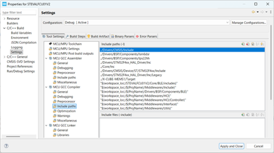

If you have already added the correct include path for custom_motion_sensors.h in STM32CubeIDE (via "C/C++ Build" > "Settings" > "MCU GCC Compiler" > "Include paths ") and the build error still occurs, first double-check that the path you added exactly matches the folder containing the header file, and that there are no typos or case mismatches. Next, verify that the #include statement in your source code matches the relative path from the include directory you specified. For example, if you added Drivers/BSP/Components as an include path, the statement should be #include "custom_motion_sensors.h". If the file is in a subfolder, adjust the include path or the #include statement accordingly. Also, ensure that the file is not excluded from the build, and is present in the project directory. Try cleaning the project ("Project" > "Clean Project ") and rebuilding it.

I tried the solution you suggested, and the original error is now gone.

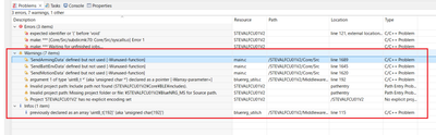

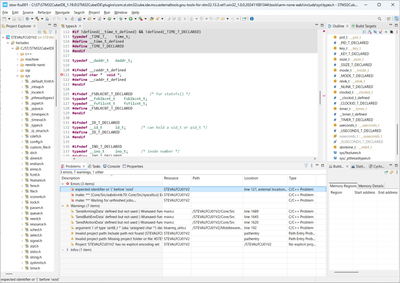

However, three new errors have appeared, and I am still unable to build the project. The details are as follows:
Error1:
Path "C:/ST/STM32CubeIDE_1.19.0/STM32CubeIDE/plugins/com.st.stm32cube.ide.mcu.externaltools.gnu-tools-for-stm32.13.3.rel1.win32_1.0.0.202411081344/tools/arm-none-eabi/include/sys"
FileName "types.h"
Message "expected identifier or '(' before 'void'"
Error2:
Message make: *** [Core/Src/subdir.mk:70: Core/Src/syscalls.o] Error 1
Error3:
Message make: *** Waiting for unfinished jobs....
Is this error caused by the two preceding errors?
Furthermore, I'm seeing 7 warnings and 1 informational message. I've attached a screenshot for your reference.
